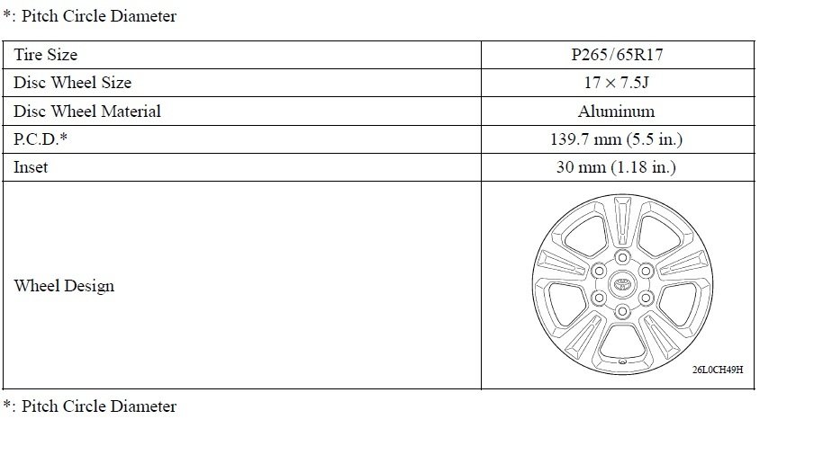

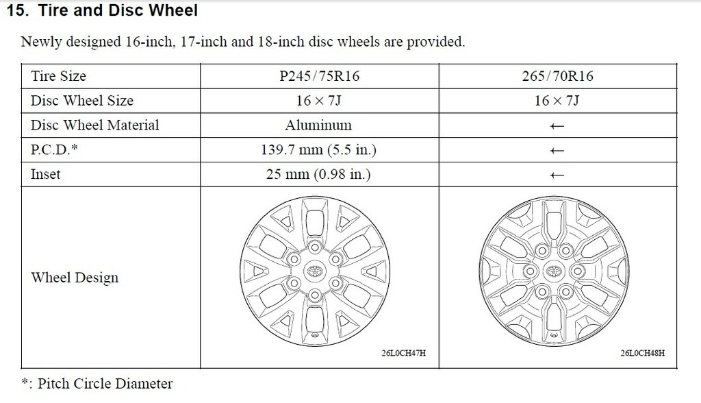

    Someone want to quote the OE tire/rim info... I can’t recall, but I think it is a +25 offset?
  10. Jan 3, 2019 at 5:54 PM
    splitbolt
    splitbolt Voodoo Witch Doctor
    Mar 7, 2010
    #32761
    7,858
    NW Arkansas
    2016 TRD OFFROAD DCSB MGM
    NoOne likes this.
