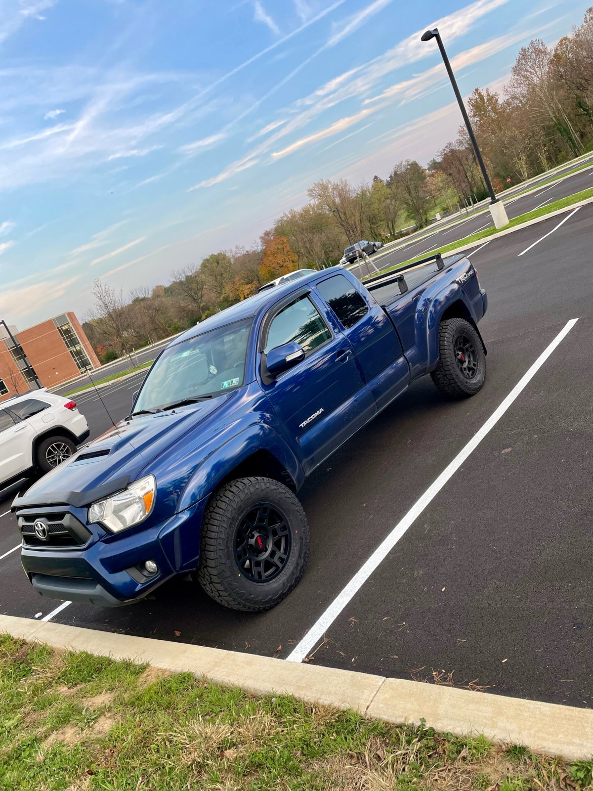

  12. Nov 6, 2023 at 2:38 PM
    #32
    tbett56
    tbett56 [OP] Well-Known Member
    Mar 1, 2017
    #212064
    94
    2015 Toyota Tacoma TRD Sport
    Update for everyone in the thread. I went with the TRD Pro SEMA wheels with Falken Wildpeak AT3Ws. I think they look great. Had to remove the rear OEM mud flaps in the front and tomorrow I will be removing the front mud flaps in the front wheel well, because they still rub a lot when backing up on even a slight decline. I'm guessing it's because the tread on the Wildpeaks is a bit beefier than the tread I had on the Nitto Terra grapplers I had before, even though the wheel and tire size remained the same. Overall, I'm pretty happy with it. If anyone has recommendations on good mudflaps I could throw on that won't break the bank, let me know! Otherwise ill just be rocking no flaps in the front.
    Also, shout out to Discount Tire for helping me with the tire purchase and for guiding me through the ins and outs of wheel fitment. And thank you to the people at Extreme Terrain for hooking me up with the SEMA wheels and giving me a no hassle price match with free shipping. Would definitely recommend both companies if you are looking for wheels/tires or if you have any questions about fitment for your vehicle!
