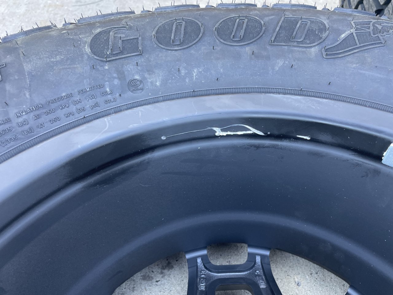

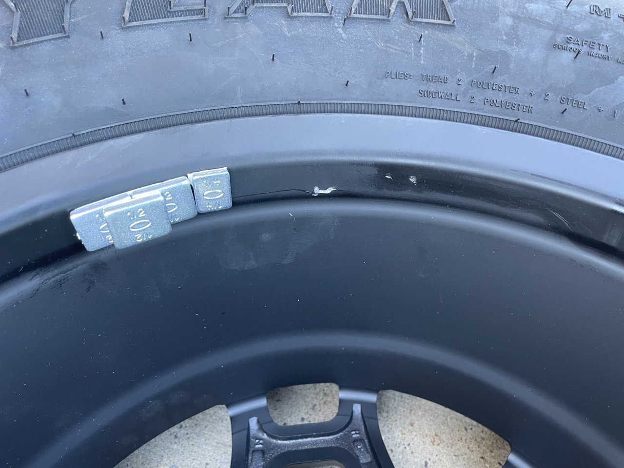

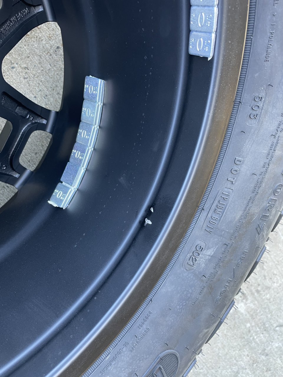

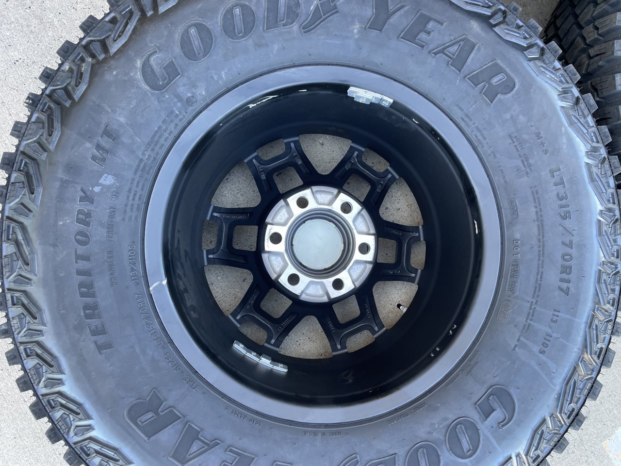

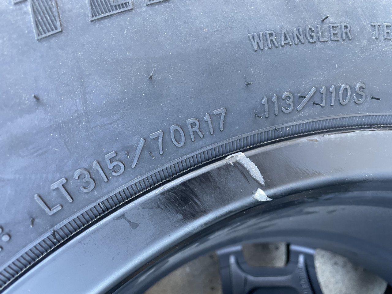

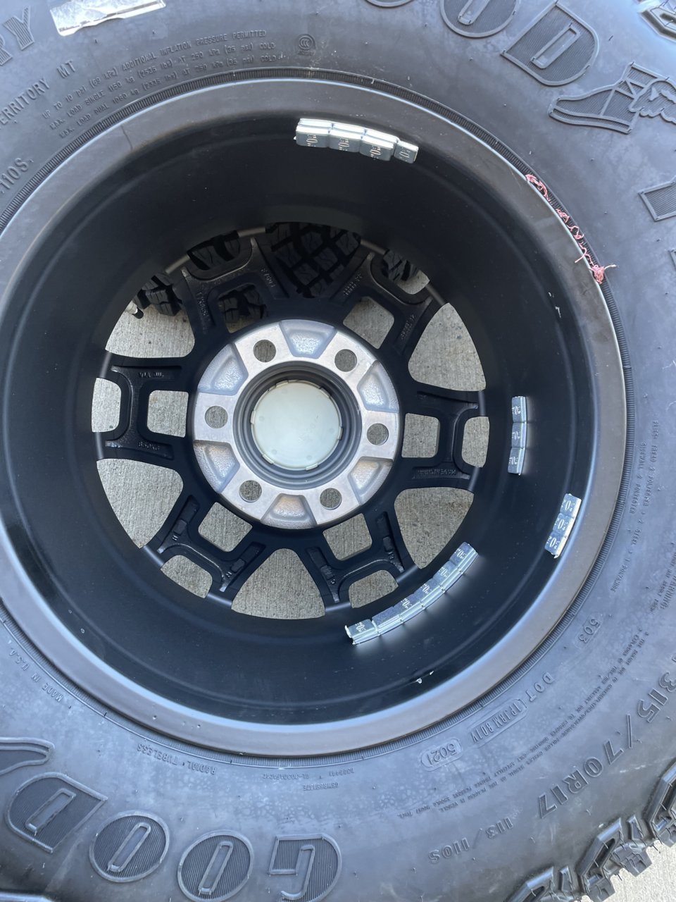

    Here is a sampling of the damages.
    Every wheel has the 4 pairs of holes.
    Shop rag in one.
    Gouge near bead/lip.
    Long gouge on one.
    And miscellaneous scratches through out.
    And how bout those wheel weights?!
    Took pics and vids on the spot. Had both shop managers present and had them put it in writing and sign it.
    Even the whole invoice was screwed up with extra charges. I'm surprised they even got the tire on the wheel.
    They will refund up to $500 if I can provide an invoice; meaning no compensation if I attempt repair. Over $500 has to go through their claims process.
    Nearest wheel repair shop found so far is +2hr drive. So could be +8 hours of drive time between pick up and drop off. So half way to max before any work is done and no way to bill that time and expense.
    Not going to reveal the perps yet, I'll just say they are The Behemoth.

    Ohhh they grabbed it from the inside like its a normal rim.
    Just lack of experience. They should definitely credit it.
    Personally I'd leave it, maybe touch up paint, but installed you wont even see those marks.

    The little “vampire” marks are where the machine grips the wheel I think. My brand new wheels got the same blemishes. The other stuff is just carelessness.
