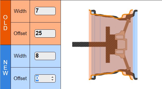

    As 3JOH22A confirmed the 245/75R16 is safe to be mounted on 8" wheels.
    Regarding the fitment, The 0 offset should fit with the 245/75R16 without any issues. If you would like to put a tape measure on the outside lip of your stock wheel and measure 1.5" out, this is about where the outside lip of the new wheel would sit.
    For a visual:
    We are happy to assist further, pm on the way

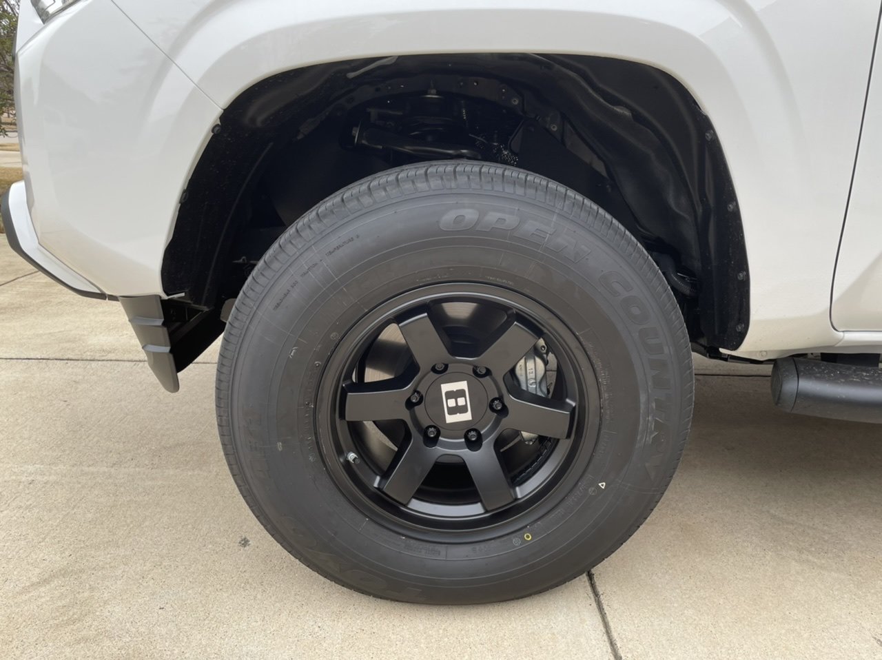

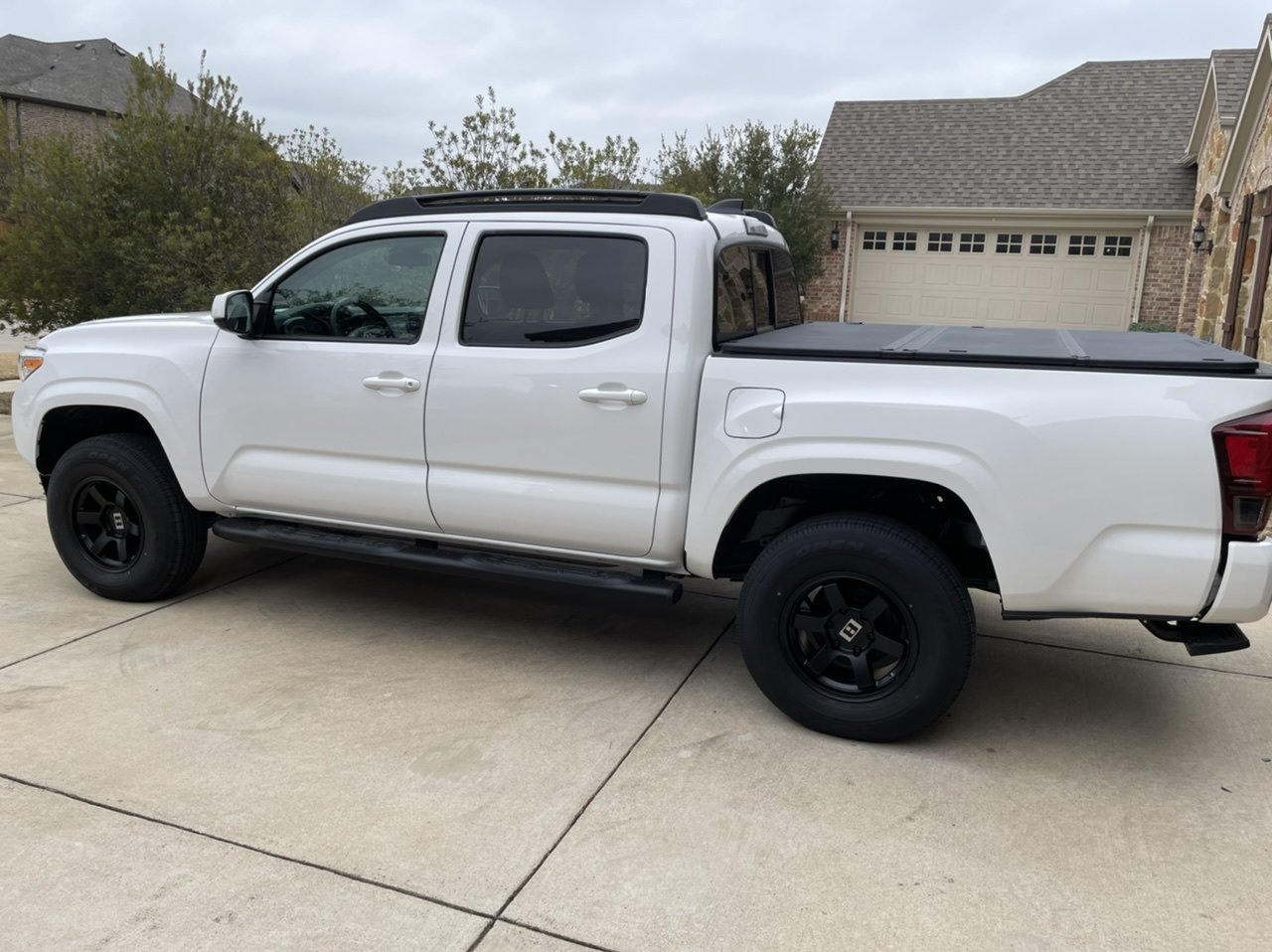

    These are what I got and it changed the whole look at the truck! Couldn’t be happier but let me know what you think.
    LEVEL 8
    LEV MK6 106.10
    16 X8 6-139.70 0 BKMTXX
    502FB51E-E9B7-4C2A-81EB-E402B86F9A7C.jpg 8EDAB866-0799-4EC9-818C-892DE949E101.jpg C8870A4A-4598-46BC-A2CC-6CA64772C621.jpg
