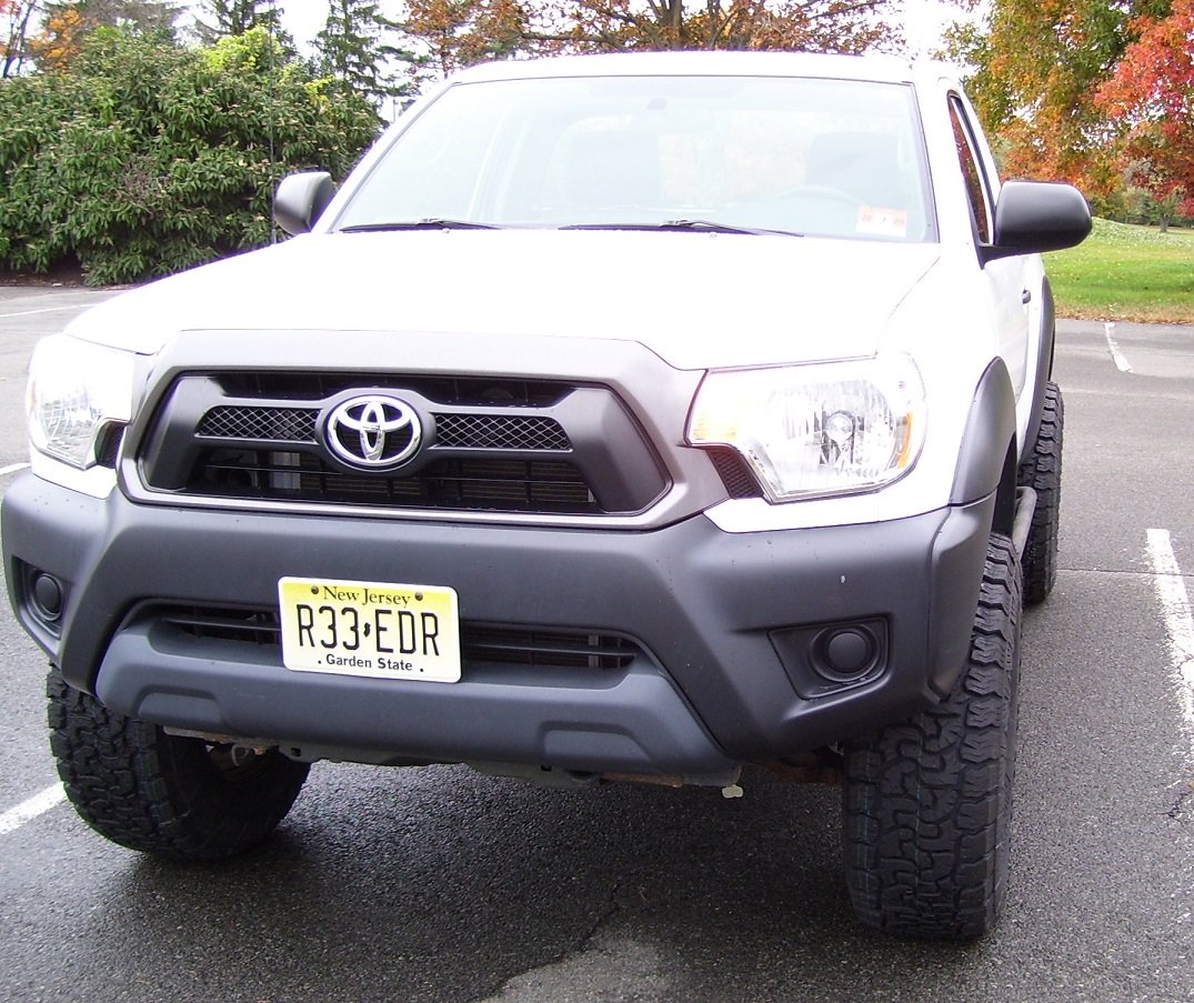

    Do you have a link to the specific wheel and specs? Depending on the width of the wheel, a 4mm offset will most likely stick out a little but not too much. I have 17 x 8.5 wheels with -10mm offset and 305 tires and they look like this. If you're looking at an 8" wide wheel then they will be about an inch further in than mine. If it's a 7" wide wheel it would be almost 2" further in than mine. But I'm not sure what the 11-mm with 4-mm offset is saying.

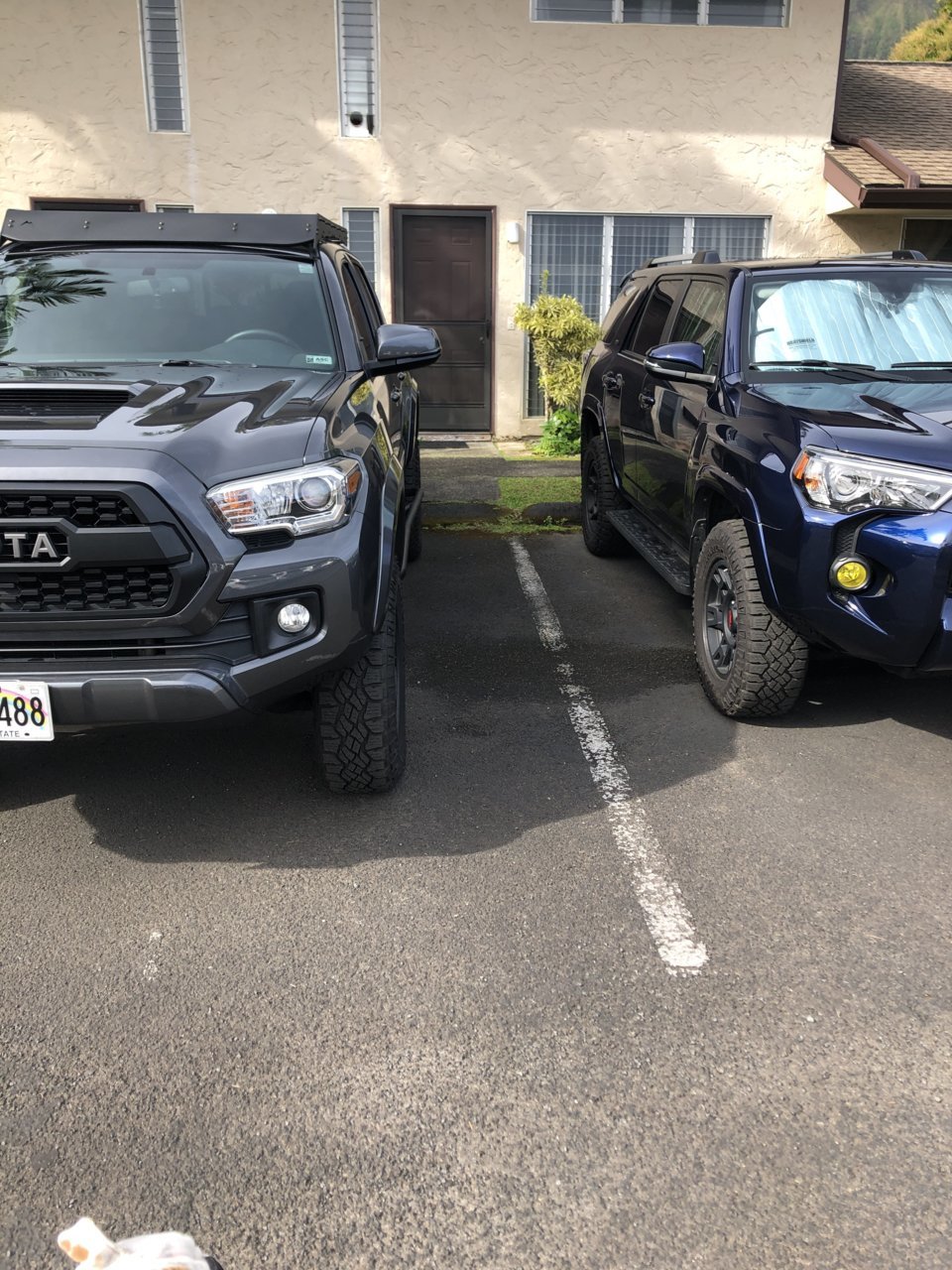

    Both Tacoma and 4Runner have them, they will not stick out
