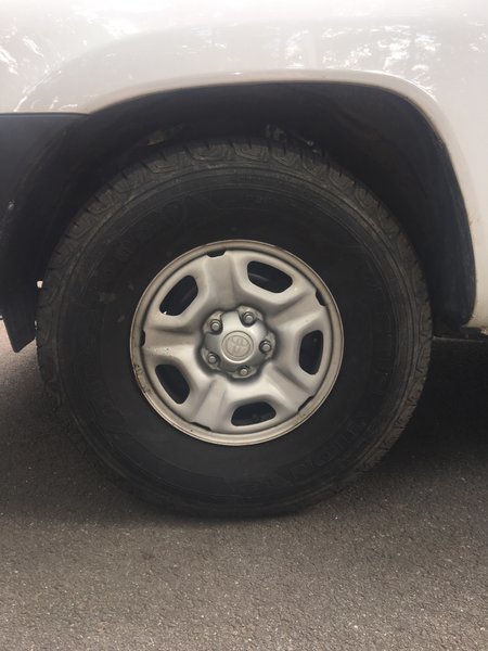

    I have 265/75r15 tires on my stock reg cab 2012 tacoma. The tires rub at full lock. Should I get a rough country leveling kit or should I get a full body lift?

    where do they rub?a body lift can help, but i would only go 1" max. else just do the cab cut.

    I was told a leveling kit may do the job

    yea a body lift wont fix that. that looks like improper wheels or tires. a leveling kit might help. does the tire hit the bar on both sides?

    Pics of the wheels might help

    Change your wheels (more offset/backspace) or add some spacers.

    So its a 5 lug no wonder why it rubs, stock size is way smaller. What made you want to go that size.
