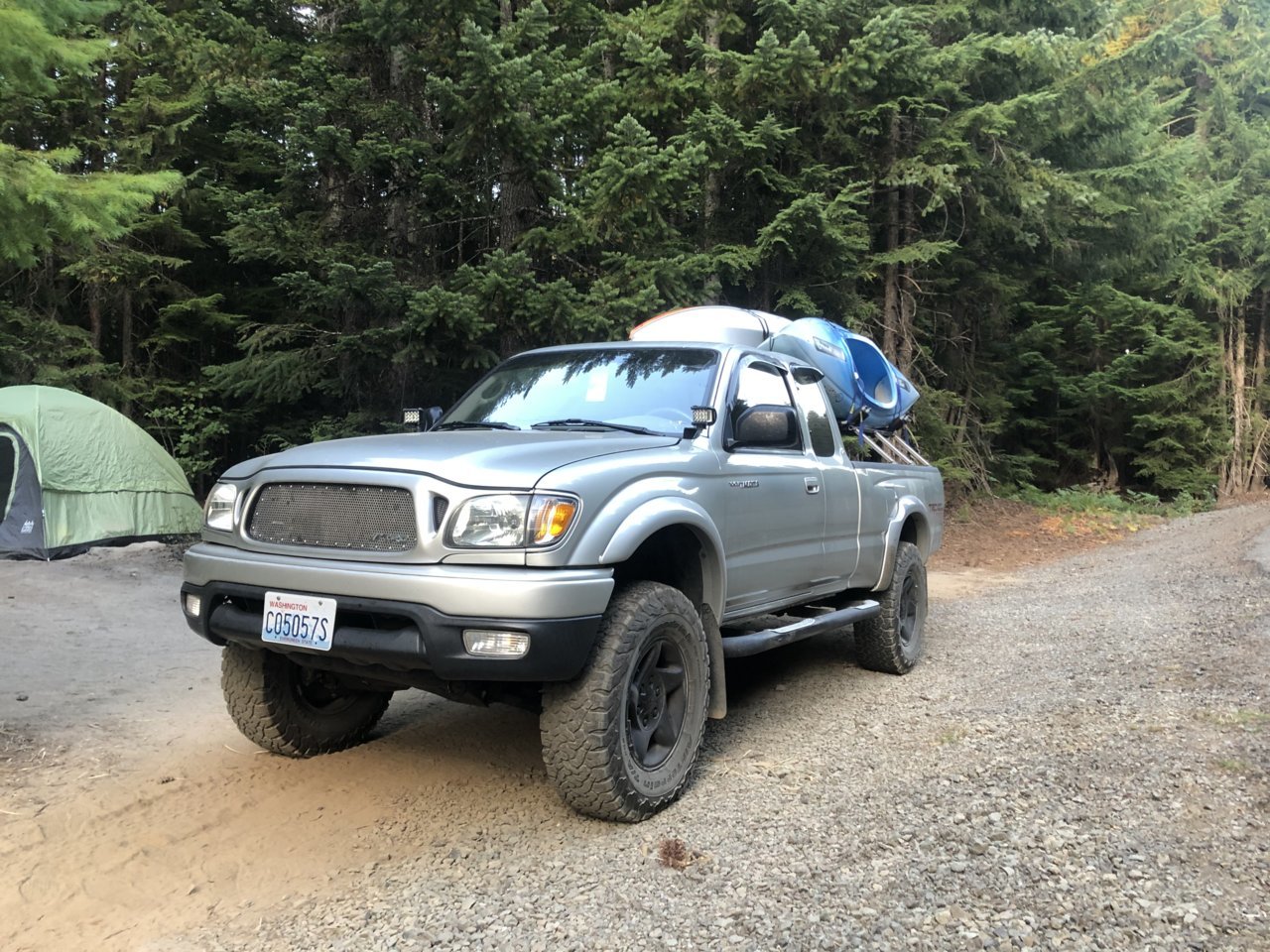

    Here's a good overview of what comes into play with various wheel/tire combos/sizes on a 1st gen. Take a read through and by all means ask questions - that suspension lift won't matter as far as what fits (at least, as you start exercising the suspension), but it can affect how much you rub on pavement. Most important for you is to understand how backspacing will affect rubbing on the frame/wheel well.
    What size tires fit my (lifted) Tacoma?
    I'm running 255/85R16, and like @jbrandt says, they are just about perfect IMO. Lots of photos on my build thread of course.
