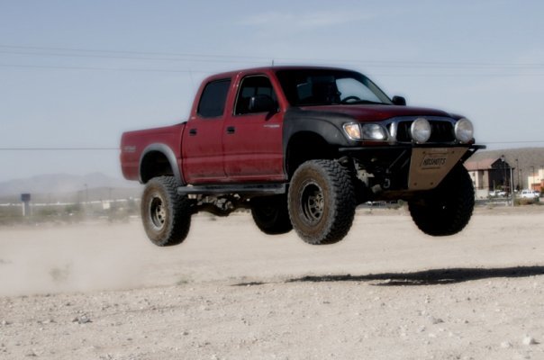

  12. Apr 11, 2017 at 12:13 AM
    mikesdoublecab
    mikesdoublecab LT Chase Truck
    Jun 15, 2008
    #7334
    7,245
    Mohawk Mike
    Glendale, CA
    01 Tacoma DoubleCab V6 Prerunner
    Engage Offroad long travel front and rear with some fat tires.
    really old photo with those wheels... i don't have a bigger file...
