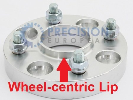

    those are not hub centric. could be your problem. u want to see a hub centric lip like this

    If they are not hub centric wheels and spacers, that's likely the issue. Wheels can be fitted with hub centric rings, spacers not so much.
