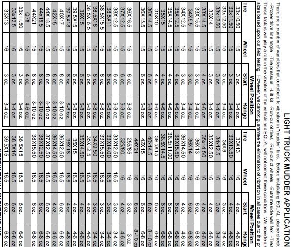

    On problem tires I use BB's
    V E R Y
    S U C E S S F U L L Y....
    The proper weight of BB's installed in the tire is key.
    Proper Weight of BB''s based on Equal's chart :
    http://www.imiproducts.com/equal/quantity.aspx
    If I wasn't such a tight ass I'd use Equal ~ The real thing.
    http://www.imiproducts.com/equal/index.aspx
    Having worked in the automotive field (Road force was after my time). Our old spin balancer generally balanced the tires at 300RPM. A Bad rim / Bad wear pattern / or a tire slightly out of true and you were screwed.
    Basically the planets had to align just right to get a used truck tire to ballance correct.
    Add to the fact that an out of ballance condition is multiplied on bigger tires and all to often it just doesn't work.
    I have my own tire machine and I have a bubble ballancer, and I run used tires exclusivly on everything but the trailers and Wifey's truck (Too many vehicles to put new stuff on everything). Over the years I've become proficient with bubble balancing and those that will not ride smooth with the bubble (or ask for more then 3oz) get the BB's.
    Just dumping in BB's doesn't work. I use the specific weight given for the packets of Equal (over the road / big truck) powder balancing. I measure out the proper weight of BB's on a postal scale. This works to improve tire balance 99% of the time and rebalances ever start & stop. + Works on untrue / blems and tires with cupped wear patterns. While it will not eleminate every bad balance situation BUT it will mask most issues and make them tolerable.
    I would not run BB's on stock tires or on new trucks as a first solution. Get it right and road force balance if necessary, but if all else fails just know their other options.
    On problem trucks with big biased tires / swampers / 33's and up / or used tires I will run BB's every time.
    More on Equal :
