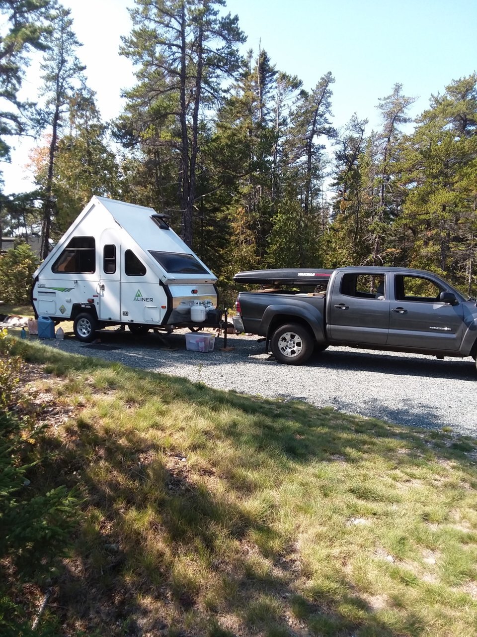

    pretty much empty. It is a pop up camper

    Nice trailer! Do you have a weight distribution/anti-sway hitch setup on it? The electronic stability system in the truck is good for that, and it’s a stretch, but could the trailer be tracking strangely?
