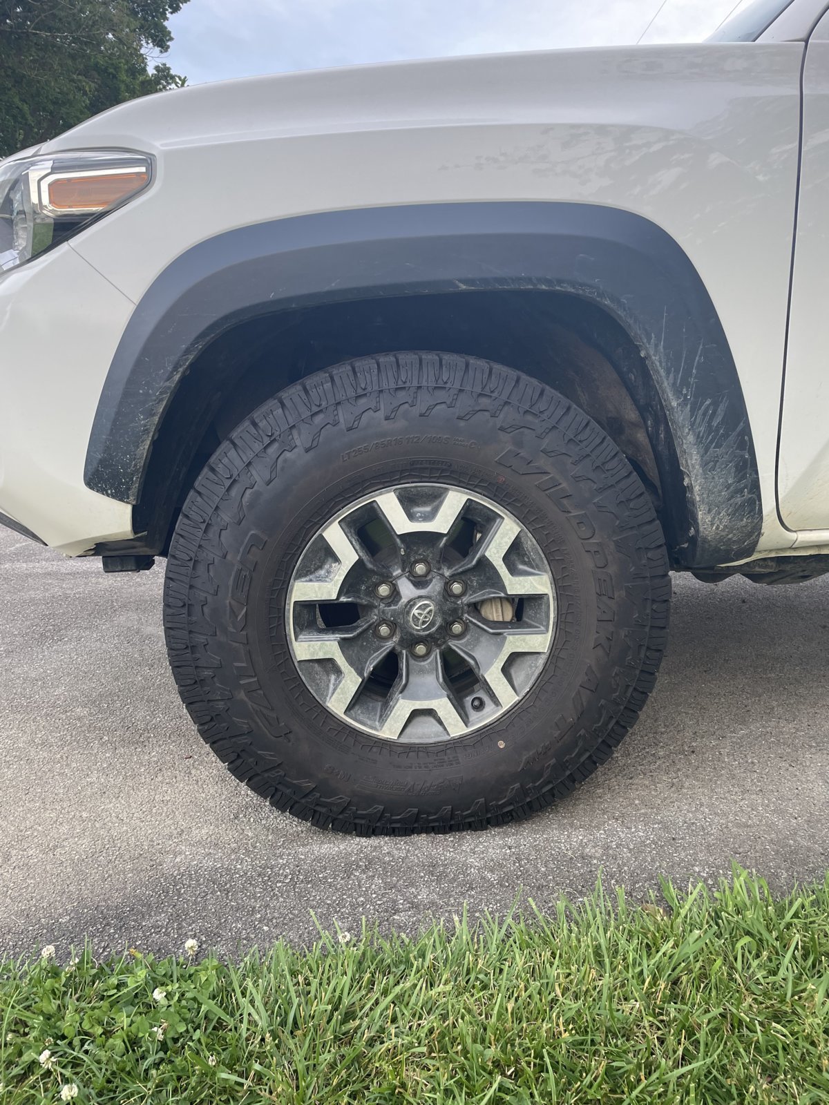

    255/85r16 on stock rims and you won't have to do anything.

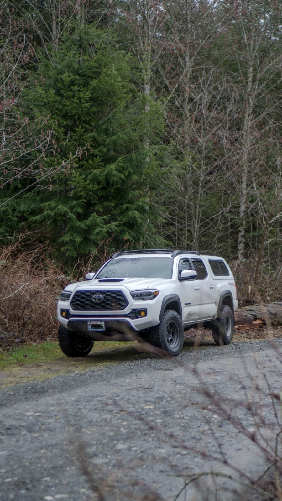

    0 to -10 offset seems to be the sweet spot. im at -10

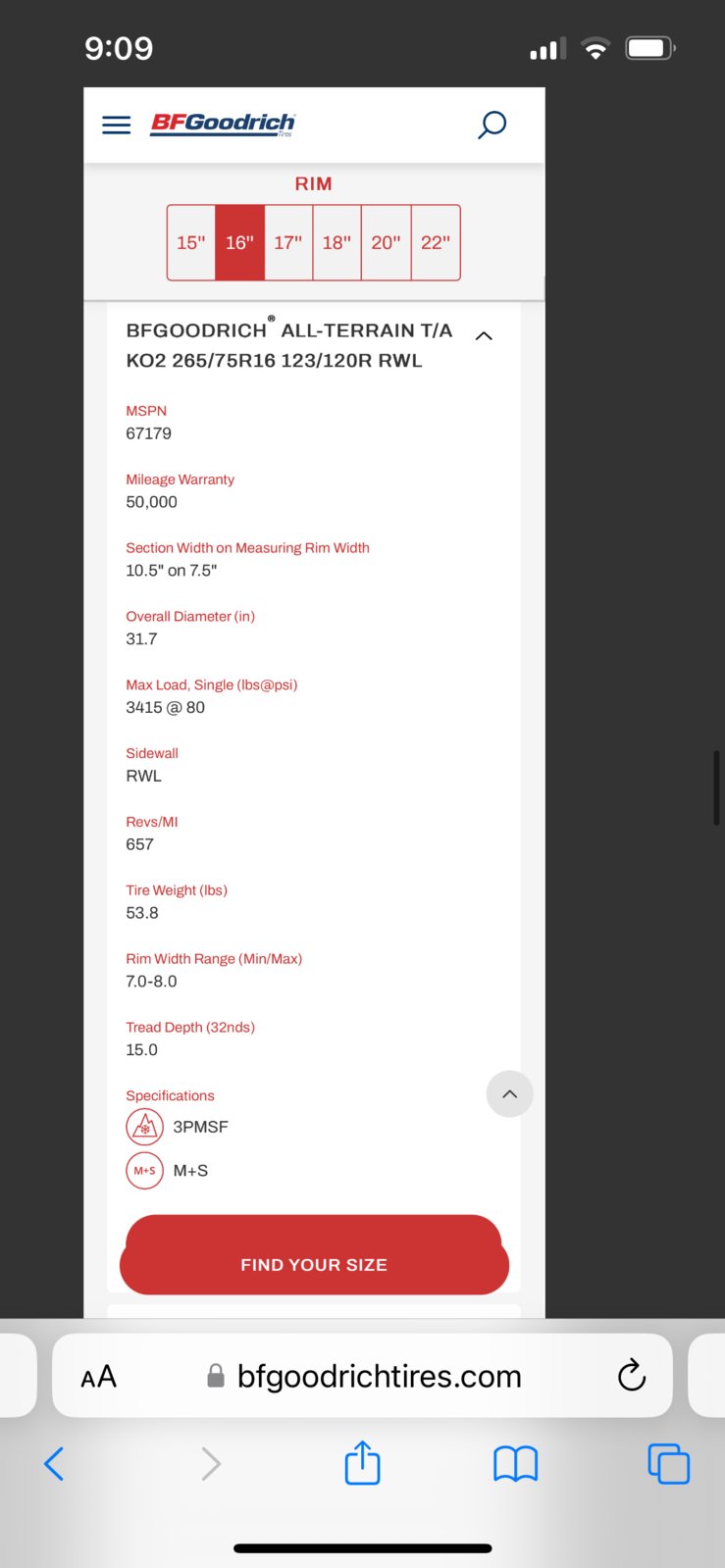

    They don’t make that tire size for KO2s but if you have any other good A/T tire recommendations I’ll check them out, these are the 2 tire sizes for the KO2 that would fit on my stock rims, would one be better over the other?
