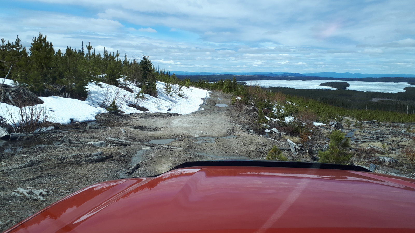

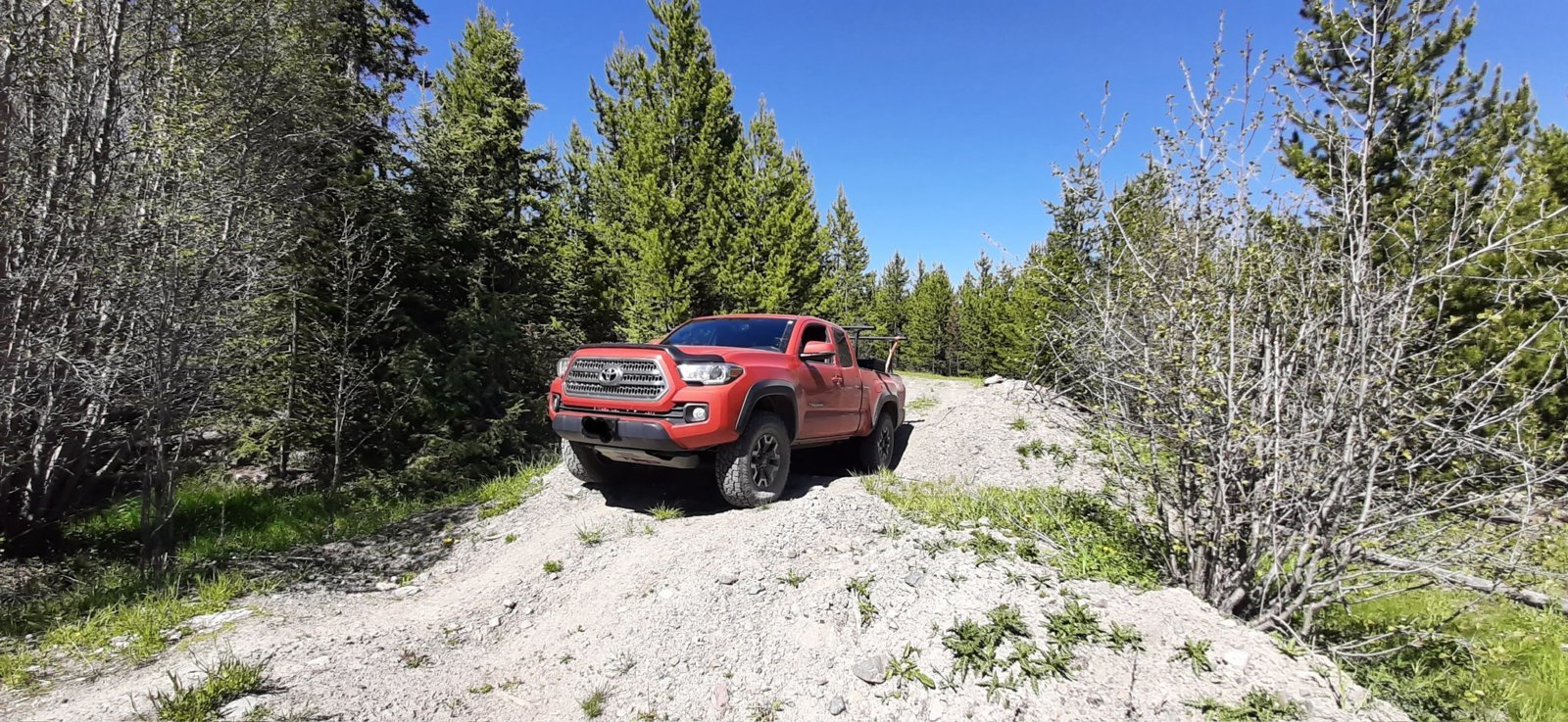

    Just added toolbox and roof-rack to haul my fishing boat 100's of miles into the backwoods every week. Goodrich K02s, Bilstein 5100 front and back, no lift.
    I have had 2 sets of KO2s on my 2016 TRD OR. Now onto my third set. I am off road every week on always bad conditions. They have never let me down. 265 75 16, no lift. E load.
    Just a few weeks ago I decided to try Toyo AT3 just for a change. Had them on 2 weeks, and hurried to get them off. Noisy as heck at high speeds on the highway.
    Off road even worse. In 4wd they would lose control on loose gravel FSRs, where my KO2s would hold tight in 2wd on the same FSRs and same speed. I had to significantly slow down on loose gravel with the AT3 and they did not feel safe.
    I always air down off road due to the very bad pothole roads. With the Toyo AT3, air down did not smooth out the ride at all. That was odd.
    Really disappointed with the AT3s. Lucky the tire shop took them back and I put my third set of KO2 back on. Thank god, what a relief off road. The KO2 on my Taco also more quiet on pavement than the AT3.
    Just my experience with weekly off roading. I am retired and going off road searching for remote fishing lakes is all I do.
    Love every trip.

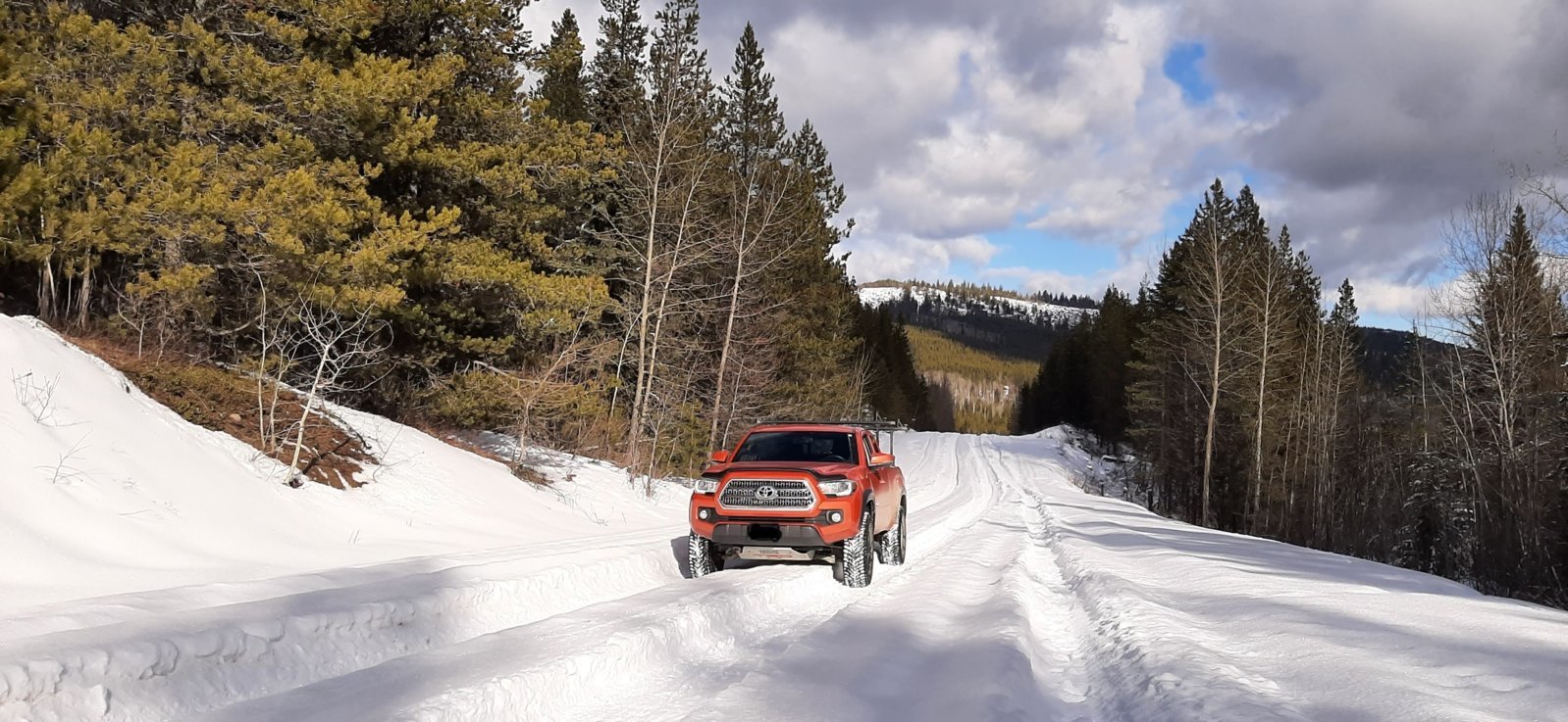

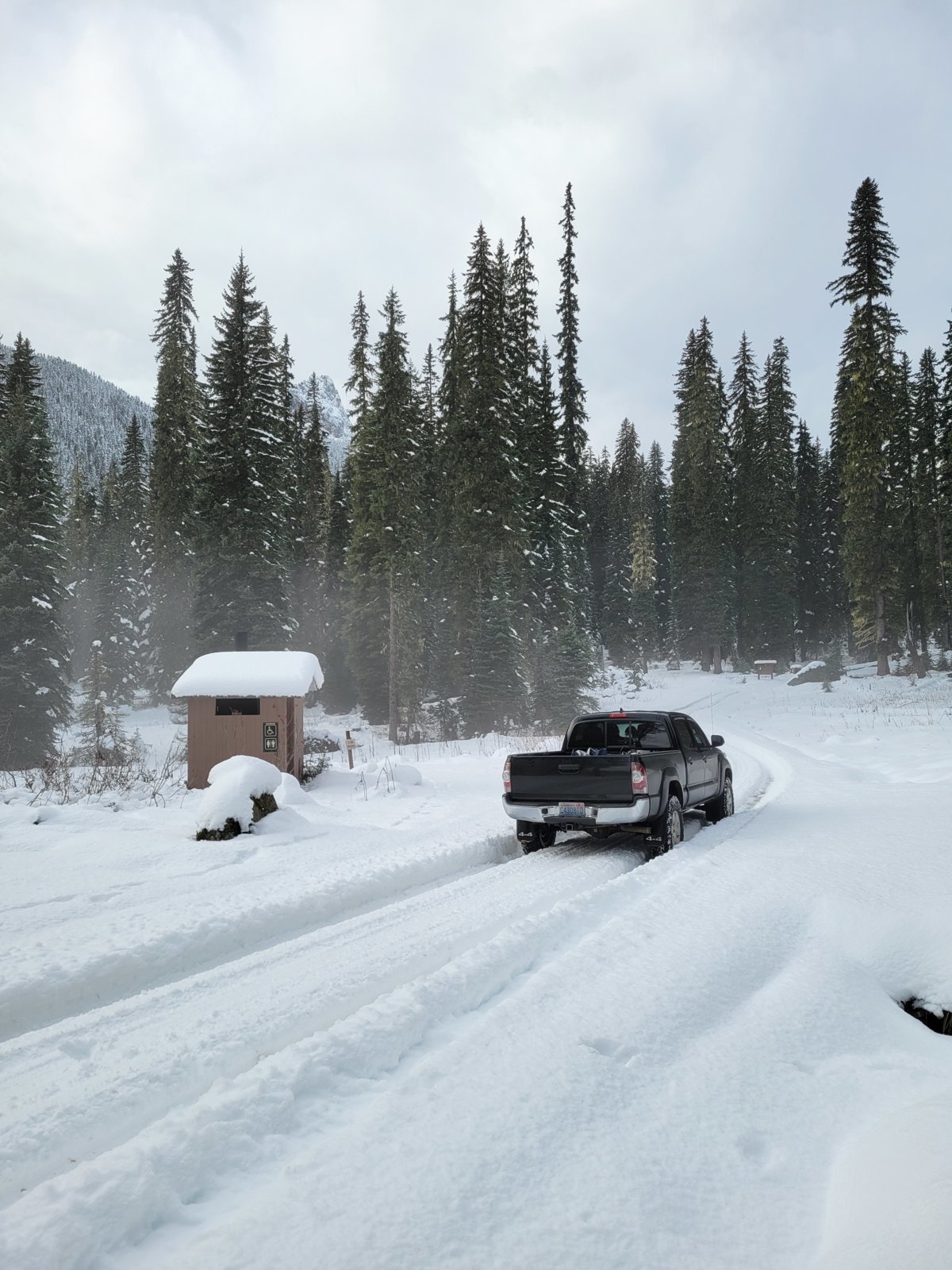

    Nice! Love the winter off roading! The AT3 likely better in deep mud than the KO2, maybe better in snow too. For majority of my off road conditions the KO2 win out.
    Those are my Nokian Hakkapelitta LT D load winter tires. I take the KO2 off in winter, too much ice on the paved city roads here.

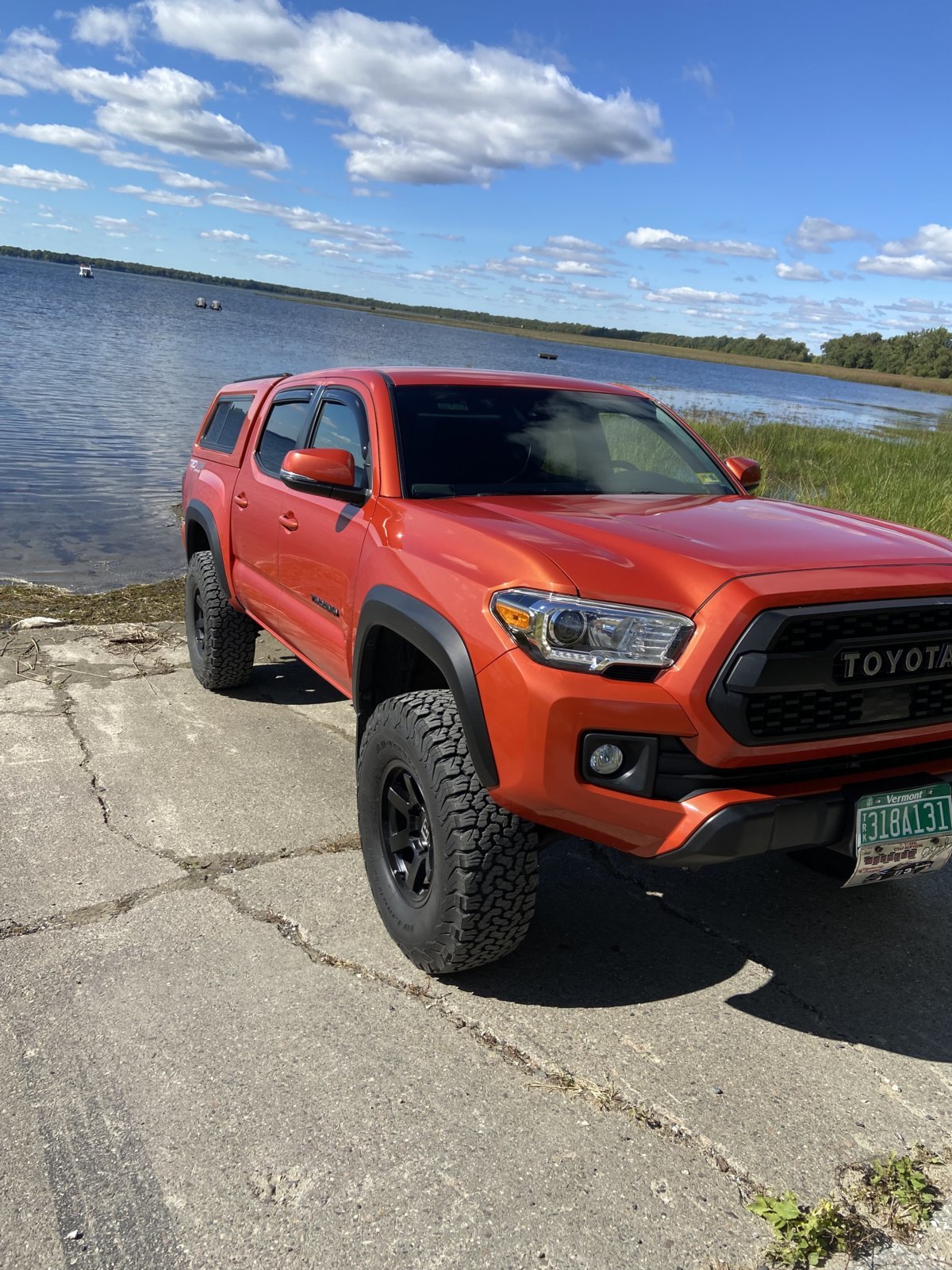

    Unfortunately Tacomas are limited to how big a tire you can run without some lifting/cutting. There is also a lot of really bad info here and on YouTube telling you that you can run this or that tire on stock suspension with little or no rubbing and with no lift and cutting. I have researched this topic literally for months and what I found is:
    1.) want bigger tires on your Taco with stock rims and suspension with no lift or cutting? 265/75R16 is as big as you can go - ie 32s
    2.) want 33s ? (not pizza cutters - full disclosure - I hate the look so know nothing about them pro or con) 285/75R16 you are going to need a lift and some trimming of the front fender well - especially if you plan to take your truck off road.
    3.) want 35s ? plan on spending major $$
    4.) tires ? everybody has their fav - I go off road so like the E rated KO2 (I'm on my 3rd set) - but honestly all you are going to get here is how great or bad a certain tire is for a particular person. It really gets down to how you use your truck.
    My truck came stock with the stock 31" Goodyear Wranglers - they were OK I guess but in my case didn't last long on some even easy trails. I put on some E rated 32" KO2 (265/75R16) with the stock suspension and rims and went off road for a year and was very pleased.
    But I wanted a little more clearance and ability to tackle some of the more difficult trails and obstacles without breaking the bank (my bank is some what limited) and went with 33" E rated KO2 (285/75R16). I wanted to make sure of no rubbing especially off road - so yeah it meant a lift and some cutting.
