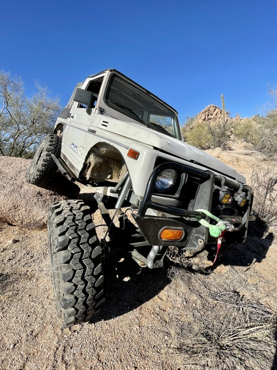

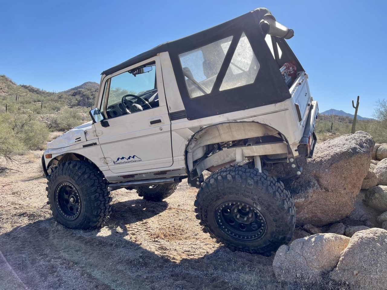

    Pick the tires you want for the axle ground clearance that you want. Pick the springs that will allow them to fit. Cycle suspension to measure for shocks. Pick appropriate shocks and shock hoops (or coilovers or air shocks or whatever suspension you are on). Cut body if necessary. Enjoy unrestricted up-travel and an insane amount of down-travel too!
    This is my leaf spring samurai on 37s w/14" travel shocks.

    Those little Samurais can be modified into some pretty nimble machines. Their small size and light weight can be a blessing, especially if you bury it in the sand.
