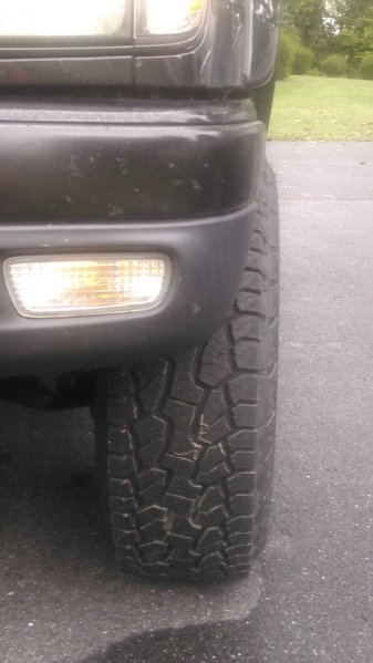

    I'm trying to figure out how much bs/ wheel width I need, to get 11.5 to stick out an inch or so (keep it sporty) past my stock fender flairs without getting wheel spacers. Thanks

    tmp_2546-KIMG0258702399151.jpg Here is what 11.5 looks like with 4.5 back spacing on 16x8 rim it's right about even with flare if you go 3.5 or 3 inch back spacing that'll bring it out past the flare an inch
