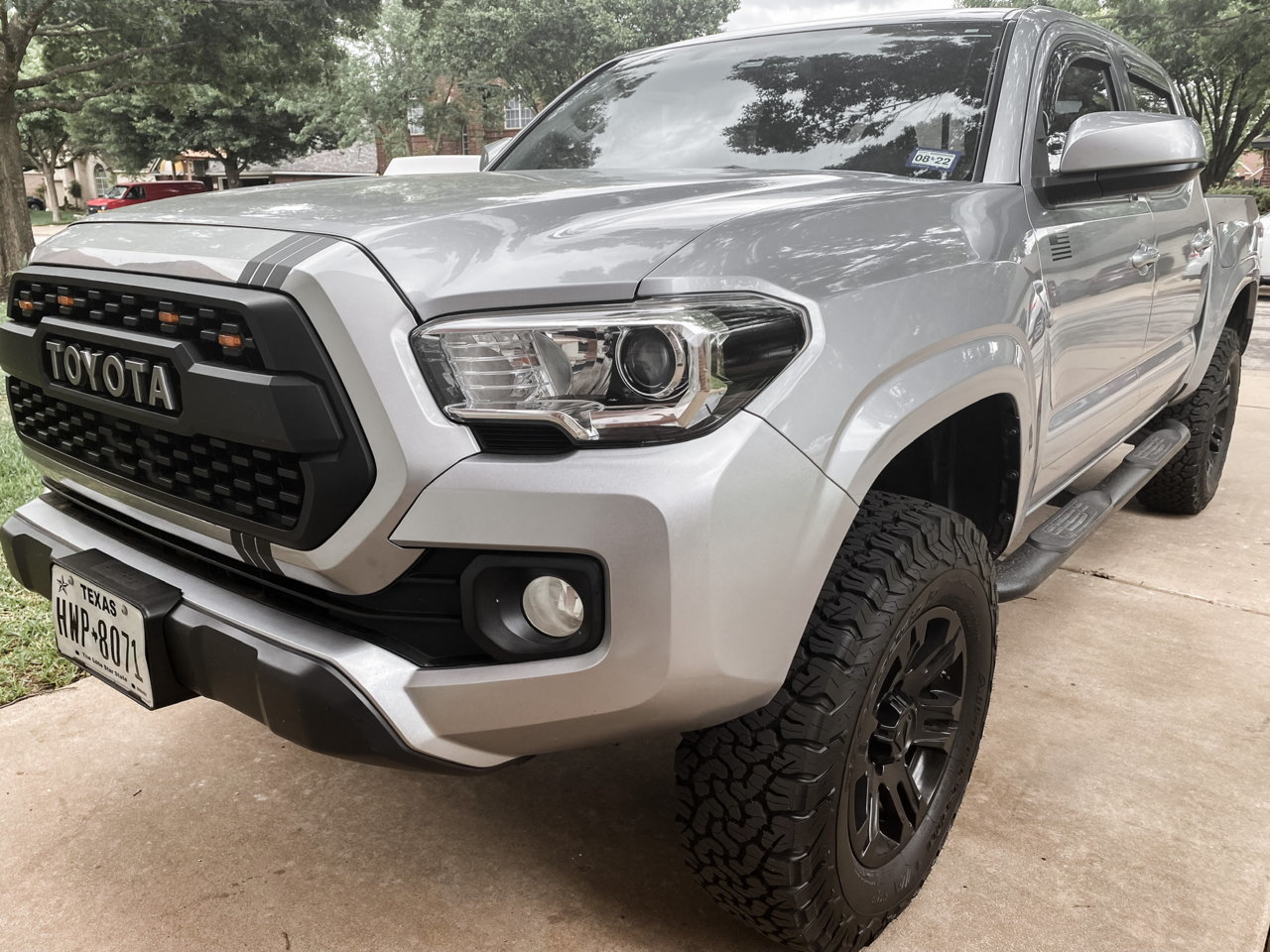

    Evening everyone.
    I have a 2016 SR5 2WD double cab with a 1” leveling kit.
    My tires are BF Goodrich all terrains at 275/70R17
    I am looking to buy 1.5” spider trax hub centric wheel spacers and am trying to figure out offset and if I will have rubbing issues. Anyone have any idea if this will work or how I can figure it out?

    Looks like TSS or Ultra Maverick wheels?

    yes sir they are TSS wheels!

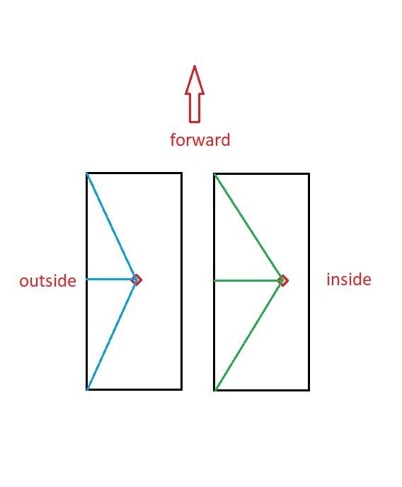

    Here's an above view of what's happening when you add spacers or increase offset.
    It places more tire on the outside of the point on which your tires pivot.
    The blue(stock) and green(higher offset) represent the different radii of the arcs the outside of the tire follows.
    The larger radius creates a greater arc and thus more movement forward/backward in the wheel well.
    Your wheel/tire also changes camber as it rotates about steering axis inclination(SAI)/+12° and caster/+2°-3°, when the wheel is turned.
