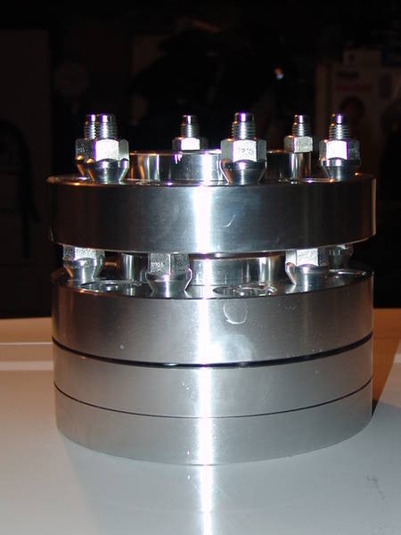

    I've got All-Pro 1" spacers on my truck and have had no problems. Make sure you get good insructions before installing them to avoid the common problems.

    You want to make sure that they are hubcentric. If not, they may not be centered when you install them and will be off-balance causing vibration just like an off-balance tire. How to tighten the nuts and use of loc-tite is important - you don't want your wheel to come off on the highway.
    Also, there are cheap ones on e-bay that might be risky from a safety standpoint. The Spidertrax and All-pro brandnames have proofed themselves to be good quality.

    ^^^What this man said. Some say red, some say blue on the loctite. I used blue, and I would say either is fine on clean threads. 85 ft lbs of torque all around (using an actual torque wrench). Don't cut any corners. They are very safe if installed correctly.

    If you want flush tire:fender I think 1" is the way to go. If you want just past flush then the Spidertrax 1.25" is it. I went with the 1.25" and there are pics in my gallery if you wanna check it out.

    If you have the stock Alloy wheels, then your best bet is the SpiderTrax 1.25" spacers. They are Hub-Centric to work with factory wheels.
