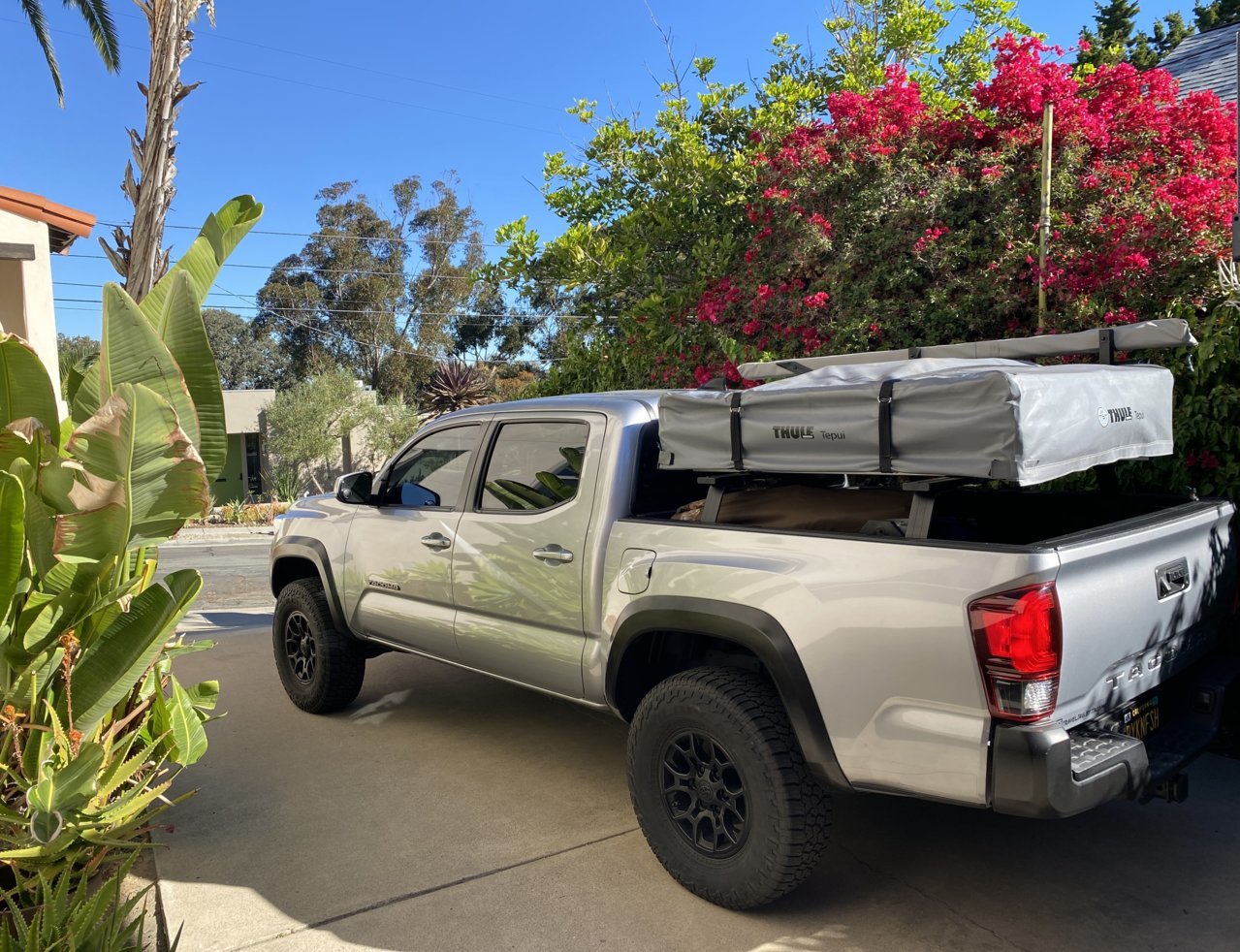

    265/75/16- spidertrax spacers with stock SR5 wheel - no issues 2 years - definitely a different feel in the steering wheel when driving on the freeway and a potential for wheel bearing wearing more quickly from what I have read.
    Bilstein 1" front lift and 1.5" Icon 3 leaf AAL in the back.

    You made those wheels look bad ass with those spacers and tires!!
    Millhouse516[QUOTED] likes this.

    Thanks! I think these are the best looking Tacoma stock rims IMHO.
