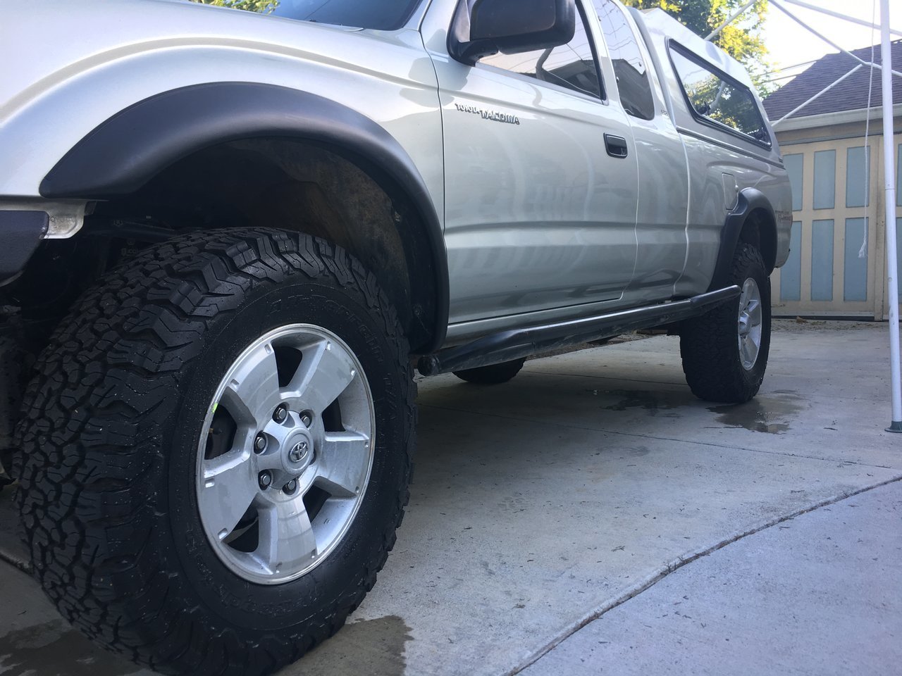

    just put 275/70R17 tires on TRD sport wheels and I am getting some rubbing on the frame from the rear of the tire. Tried to research but can't figure out how to determine the correct wheel spacer size that I need. Any help is appreciated.

    I think the offset on those rims is +30 not +32. If my calculations are correct, a 1.25" spacer will get you near 0 offset.

    Bora also makes .75" spacers as well. Somewhere between .75 and 1.25" will be fine. Just keep in mind that the further out you go, the more likely you'll rub the fender.

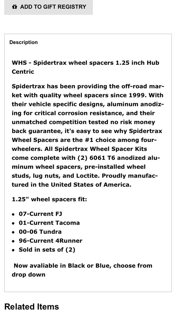

    I just took my 1.25" spidertrax wheel spacers off & sold them for $160 shipped for all 4. I looked on ToyTec.com & Spidertrax.com and they said Spidertrax wheel spacers only fit 01 Tacomas & newer. Then anything before is different. The ones that fit the 01 & newer Tacomas, fit other models too. But not 95.5 & newer. Unless they just don't state it for some reason.
