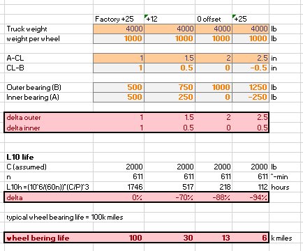

    I always hear people say spacers or less offset will wear bearings faster. Some claim they have gone thousands of miles with no issues...others have bearing failures within a few thousand miles.
    I have yet to see real numbers run...so I took a stab at with a napkin calc.
    From what I see...even a half inch spacer will load your outer bearing with 50% more load. If your wheel centerline lines up with the outer bearing, it will see all the load.

    CONCLUSION: even a small spacer will significantly change bearing load, bearing wear, but until we know the bearing spec, we can't quantify the loss of bearing life.

    Far right column should be negative 25

    Nice work! I’m curious how tire & offset combinations would factor into your calculations.
    i.e., 65lb-285mm-factory offset vs 45lb-235mm-1”spacer
    Which would wear out bearings faster?

    Good question. I would bet the spacer would wear the bearings out faster than a heavier tire. Since this calc is independent of tire weight, it's hard to factor that in.
