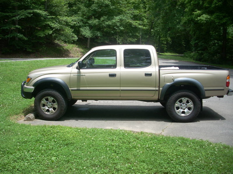

    These are the new wheels I have.
  5. Jan 9, 2018 at 6:26 AM

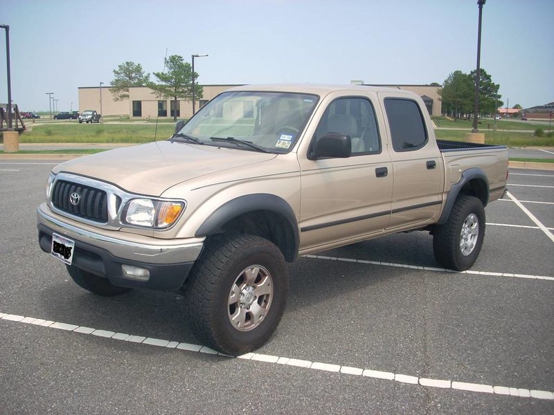

    Factory 03 wheels currently on truck.

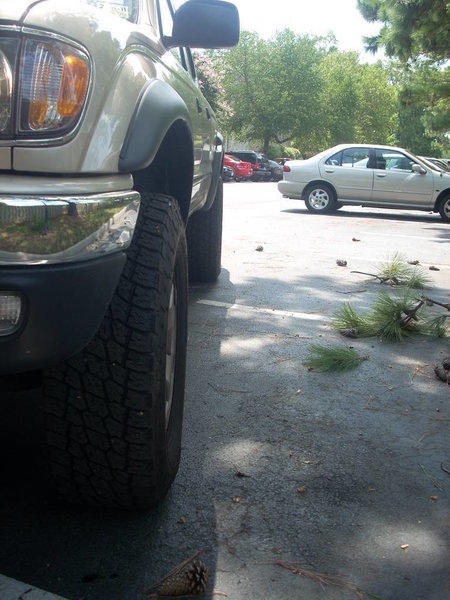

    Ok, different style. I could see how there may be some interference with the caliper.
    This is what mine looked like with 1.25" spacers.
    ohpd1100[QUOTED][OP] likes this.

    Correction... those are 1.5" spacers. I checked my posts from 2010 to make sure.

    Good deal. Kinda gives me an idea on how much they may stuck out. I can dig that, looks good!
