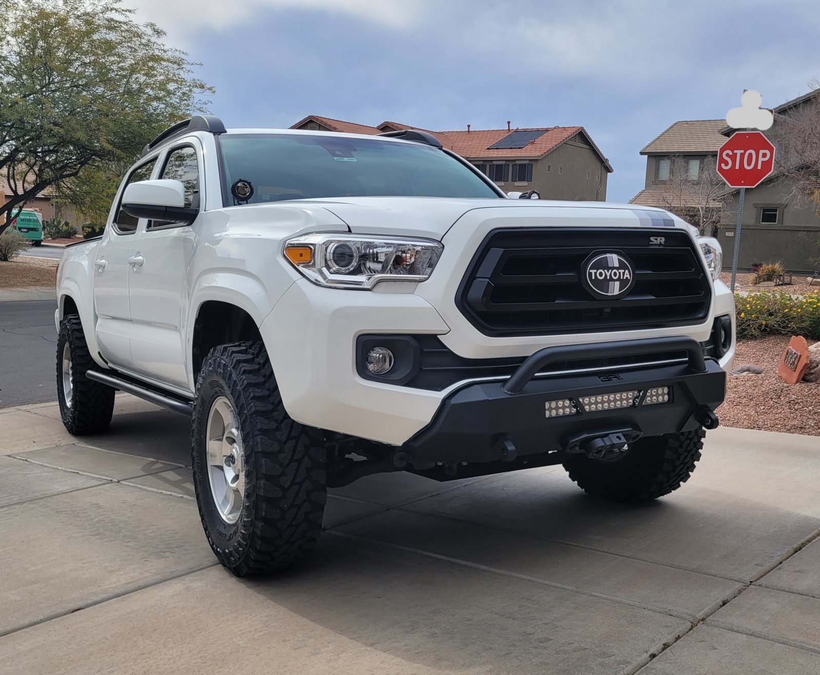

    Southwest Tacoma
    Southwest Tacoma Well-Known Member
    Mar 5, 2020
    #321331
    396
    Southwest
    2020 Super White SR DCSB
    I've got 1.25" hub centric aluminum spacers. Will be 4 years this summer. Love the stance, no issues with vibration. Using a different Toyota wheel but you get the idea.
