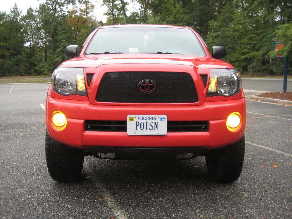

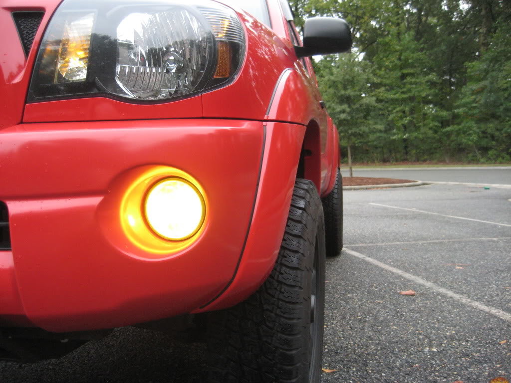

    I have some eBay lug centric ones. I don't wheel, but I definitely have a heavy right foot and love to hear my CAI and exhaust scream together. That said, I think if anything were to go wrong if the spacers I have, it would of happened by now.
    The hub centric ones are preferable to most (even me) but they are designed to go on OEM rims or rims with a 105mm hole for the hub. So if your rims aren't 105mm in the back you might as well have bought lug centric spacers.
    The most important thing with lug centric is to take your time lining up the rim on the hub as you gradually tighten each lug. Making sure the whole time that you're not digging a lug into the side of your rim-lug-holes.
