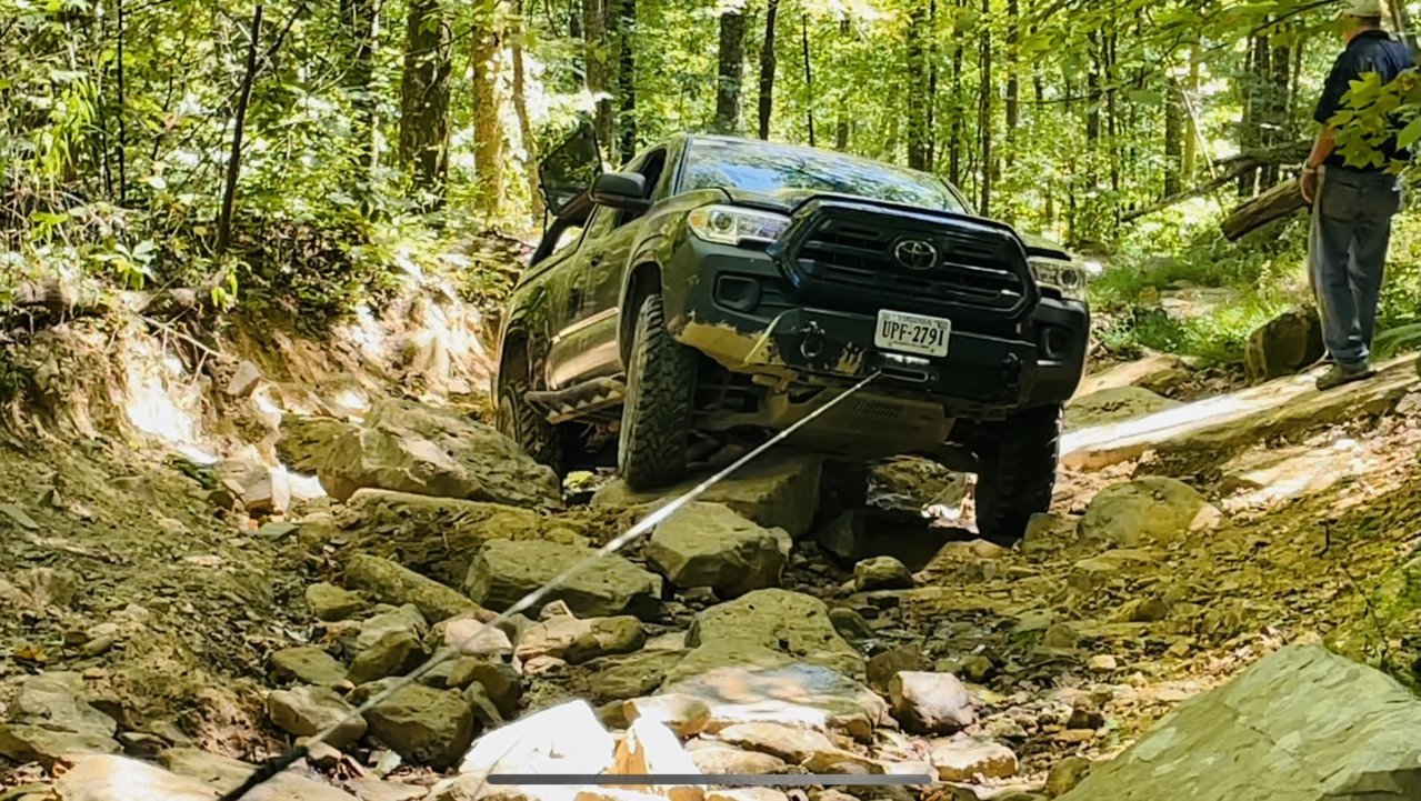

    I have a set of 255/85/16 toyo open country MT’s that are dedicated for trail use. The issue I have is that they’re very narrow. They do not protrude from the fenders whatsoever and for off road use, I kind of would like them to. Going into heavy off camber ruts and having the side of my truck right on the wall isn’t a pleasant feeling. Having the tires stick out a little farther so that they will make contact with the wall and not the entire side of the truck is the goal. I have read good things about bora/spidertrax however most people are using them for looks. What’s the overall consensus of using them for off road ?

    If you run a high quality, hub-centric, wheel spacer you're fine. Boras, sypdertrax are good quality. You'll be fine

    We run BORA on many builds and wheel every single one of them. Never had one issue. This is even on Long Travel rigs where they get some air and crawl harder than pictured. Modest size quality wheel spacers properly installed are nothing to be concerned about.

    Based on your experience with these and the width of the tires I have, what size spacers should I go with ?

    I had the spidertrax 1.25” spacers on for about 6-8 months and had zero issues with them. No vibrations or anything and I liked them. Only reason I don’t use them any longer is because I went with a -25 offset wheel.

    Depends on your wheels. 1.25" gets the lugs on the spacer recessed and puts your outside edge in a similar place to where it would be on a 12.5" wide tire. It may require more trimming/pounding on the lower rear part of the fender. Going bigger than 1.25" will keep widening the track and increase the likelihood of rubbing that spot.

    People put 255's on thier truck because they fit without modification. 285s and 12.5's typically need CMC, heavily adjusted alignment, smashing the pinchweld etc.
    A 1.25" space will basically push your tire out to be line with where a 285 or 12.5 would sit.

    If youre on stock rims then 1.25 spacers will be pretty close to the same thing as running -10 offset. Once you go more like 1.5" it will start to become more problematic to clear. But with your narrow width tires it might be fine to do 1.5 as well
    Plus a cmc would fix any issues w the skinny 33s anyway.
