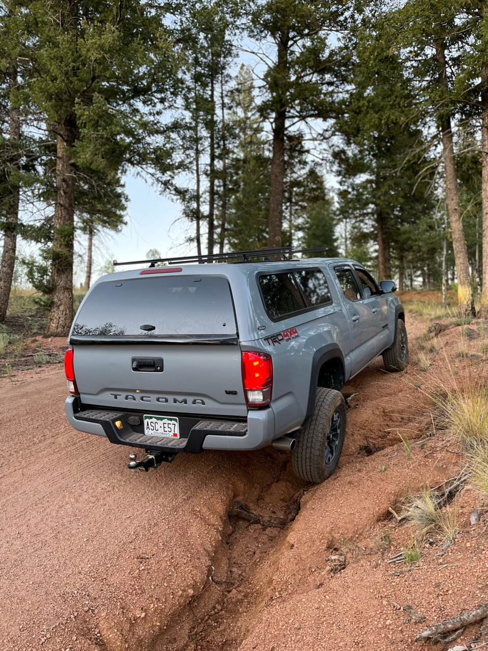

    Here’s my stock 21 Tacoma with 1.25” spacers.

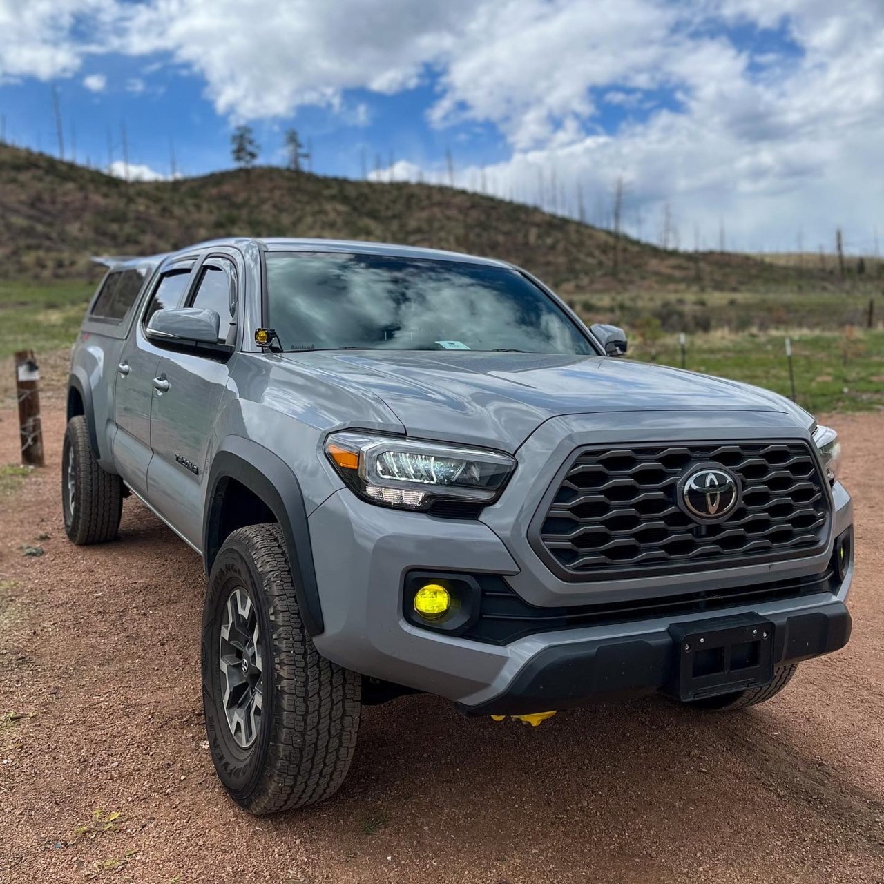

    Looking very good, thanks for the input. Idk the difference in backspacing between factory aluminum rims and the steel rims, but with your aluminum rims there, do the tires actually stick out past the fenders with the 1.25 spacers ?

    The tires sit just inside the fender edge, at least in relation the top horizontal section of the fender. They do sit a little outside the side vertical sections of the fender, since the bottom of the fenders curve in a bit.
    Here’s the only other pics I have of my truck, spacers on in each.
