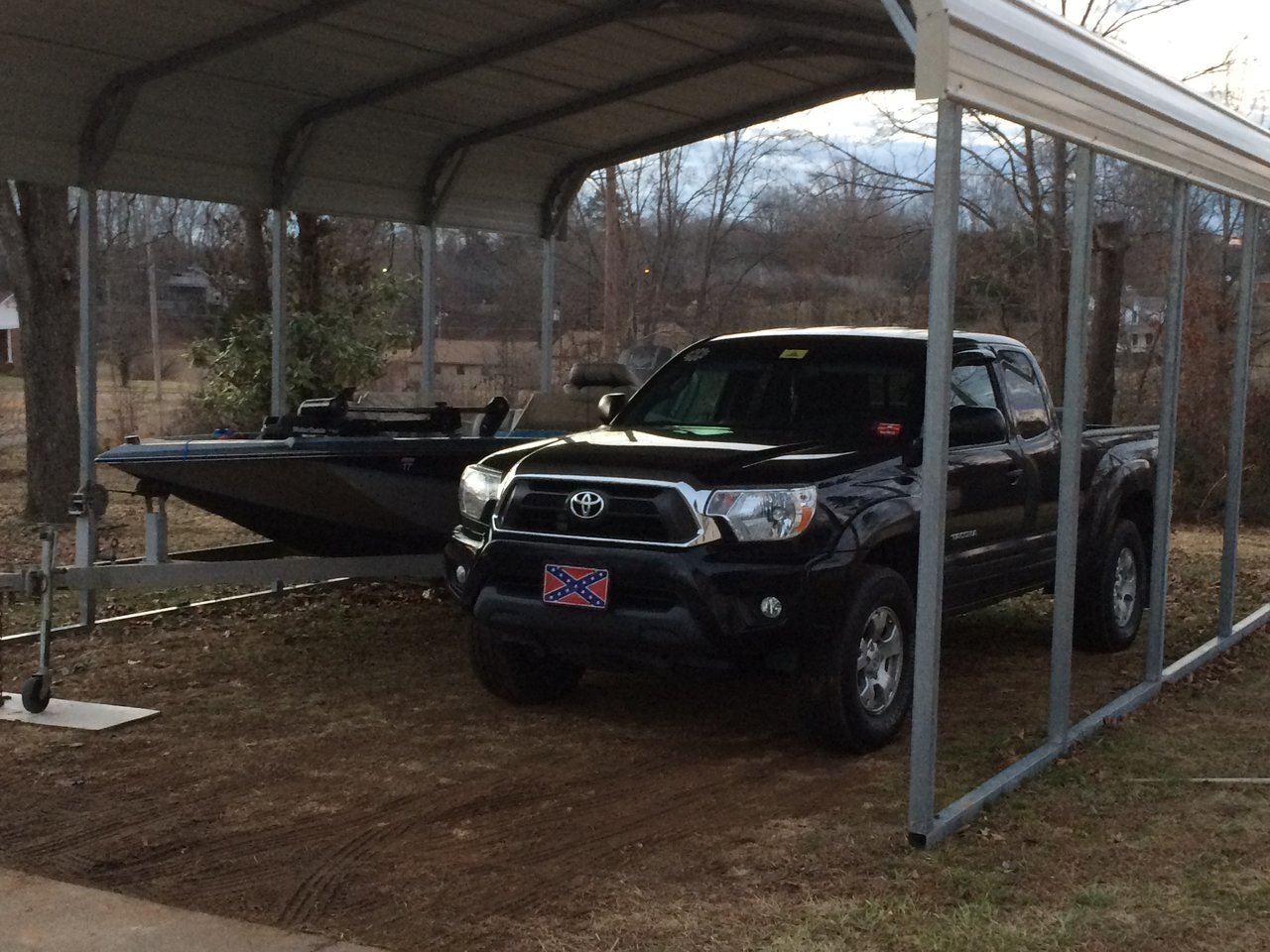

    hey folks,
    my names lee and i own a pretty much stock ‘13 tacoma trd sport access cab 4.0 and i have the factory aluminum rims.
    i want my wheels to stick out just a tiny bit more to give it more of that bulldog stance we all love so much,lol,and my budget wont allow for a new set of rims so my question is if and how can i achieve this without buying new rims ? is it safe to put small wheel spacers in,like maybe a 1-2 inch spacer on each wheel ? and will that do what im wanting done ?
    please and thank you,
    lee

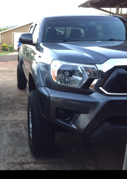

    Hi and welcome to TW! I have the spidertraxx 1.25” spacers on my truck with the trd wheels and this is what it looks like with them on. 52E678DA-715C-49BC-AF55-2918D80ADA1B.jpg

    thank you all very much.i had asked around in the local offroad shops but theyre arent many nearby and the few that are i think are more interested in trying to sell me some new rims than a simple set of spacers...lol.

    okay and ty too
    after 24 hours of additional research based on your alls pictures AND advice and what ive seen is available vs.what seems to be common i have an additional question please ....
    does anyone run the 2” model ? dont get me wrong,im happy to hear that i can do this at all but say i wanted mine to stick out a tad further,how much is too much and just not safe by any standards ?

    hub centric,got it.when i first asked i thought 1 inch would be plenty for my taste but after seeng a few pics i might want a bit more if possible.dont get me wrong,i loved them all but this one is mine and as you may well have noticed by the plates and gun rights stickers that i am also a son of the south and we like em WIDE down here.lol.but i wanna be safe and not tear up my toy either.lol
