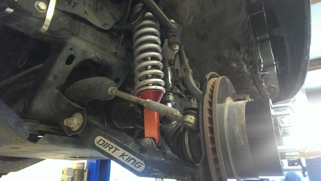

    Kind of a bad picture, but here it is so you can see it. Securely mounted to the hub, studs mounted within the assembly to ensure a solid mount to the wheel.
