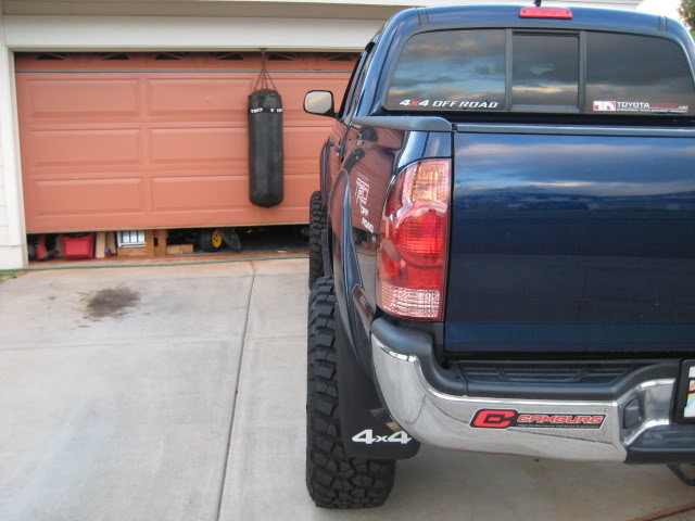

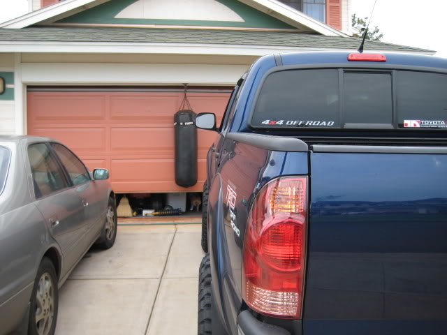

    I'm running 17x9" rims with a 4.75" BS but it's because of the BFG KM2's. These tires aren't as wide as some other brands out there. Without the spacers they stick out about 1/4". So you will still need Bushwacker flares.
    I'm currently waiting for BW to release the flares for the short bed.
    This is what they look like without the spacers:
    This is how much they stick out with the spacers:
