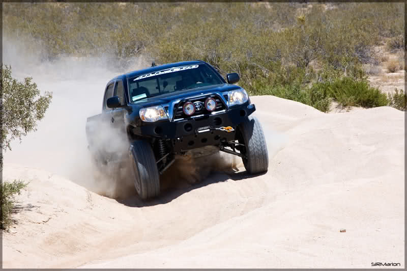

    Yup. Spidertrax 1.25" wheel spacers. Old pics, but you get the idea.

    Those are 285/75/16's or 33's. 30k miles later, and they're still on my truck. The wheels I bought were not the right offset and the spokes were rubbing the calipers. Only problem I have now is one of the studs on the drivers side spacer is a "little" bent. I wheel my truck pretty hard, so it's not really under normal driving conditions. I also have a bent spindle on that side, so you can see where I'm coming from. I think the manufacturer will replace it for free for me anyway.
    Other than that, as long as you apply some blue loctite to them each time you open them up, and keep them torqued correctly, they should be fine.

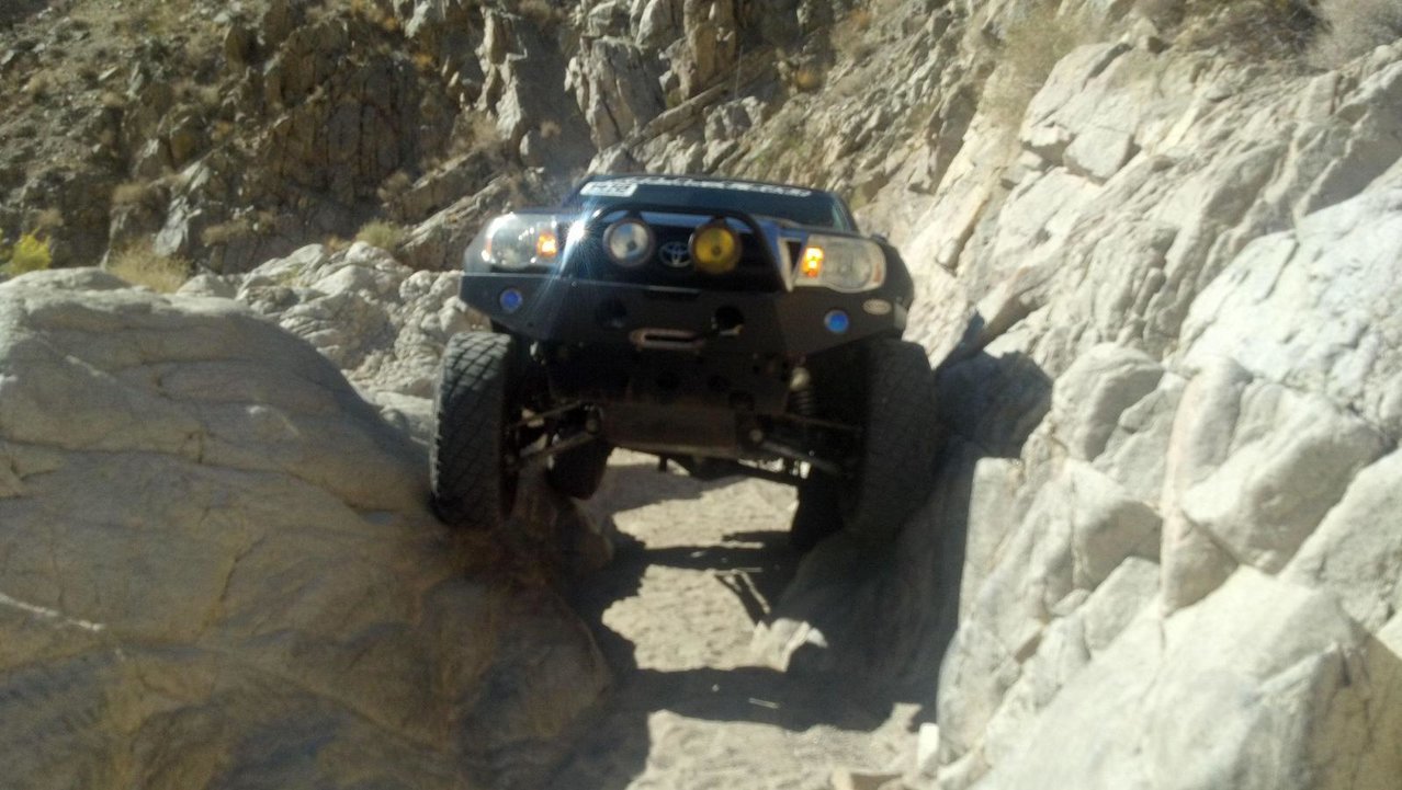

    I run spacers in front in conjunction with my LT kit. I have the spacers to help clear my spindle gussets other wise my tire will rub but very slightly. keep in mind tho that I'm running 35" tire..and just like the OP stated, all I need was just 1/4" more clearance. I wheel my junk like its stolen and Havnt had any issues yet with running the spacers...
