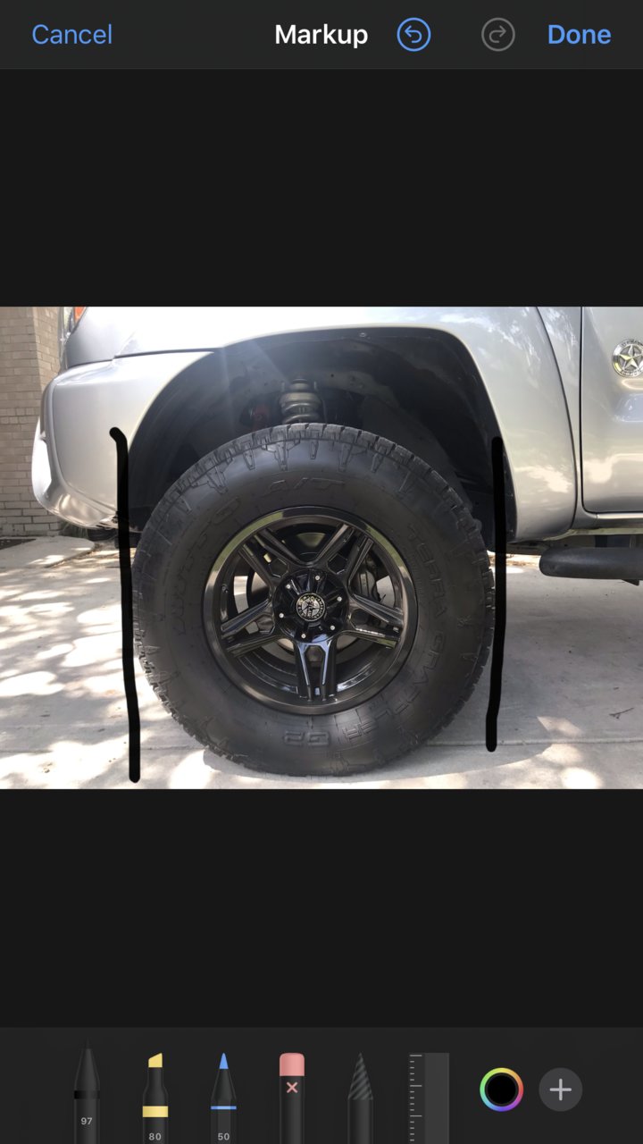

    So if you put a ruler up against the tire vertically and install the spacer I assure the the two edges of the tire will still be it between the rulers. Meaning the tire is still in the same space it was other than being further from the hub but what you have done increased the track width of the truck meaning it’s turning radius is wider than it was that’s why it rubs it not that the tire itself has moved and no it’s not rocket science you just don’t understand what happens when you increase or decrease track width and how it effects turning radius. Cute drawing though.
  16. Jan 1, 2020 at 6:50 PM
    #36
    gotoman1969
    gotoman1969 Well-Known Member
    May 30, 2018
    #254966
    6,984
    Steve
    San Antonio, TX United States
    2015 Silver Tacoma PreRunner
    3" ToyTec coilovers, JBA UCA's, Bilstein 5100's

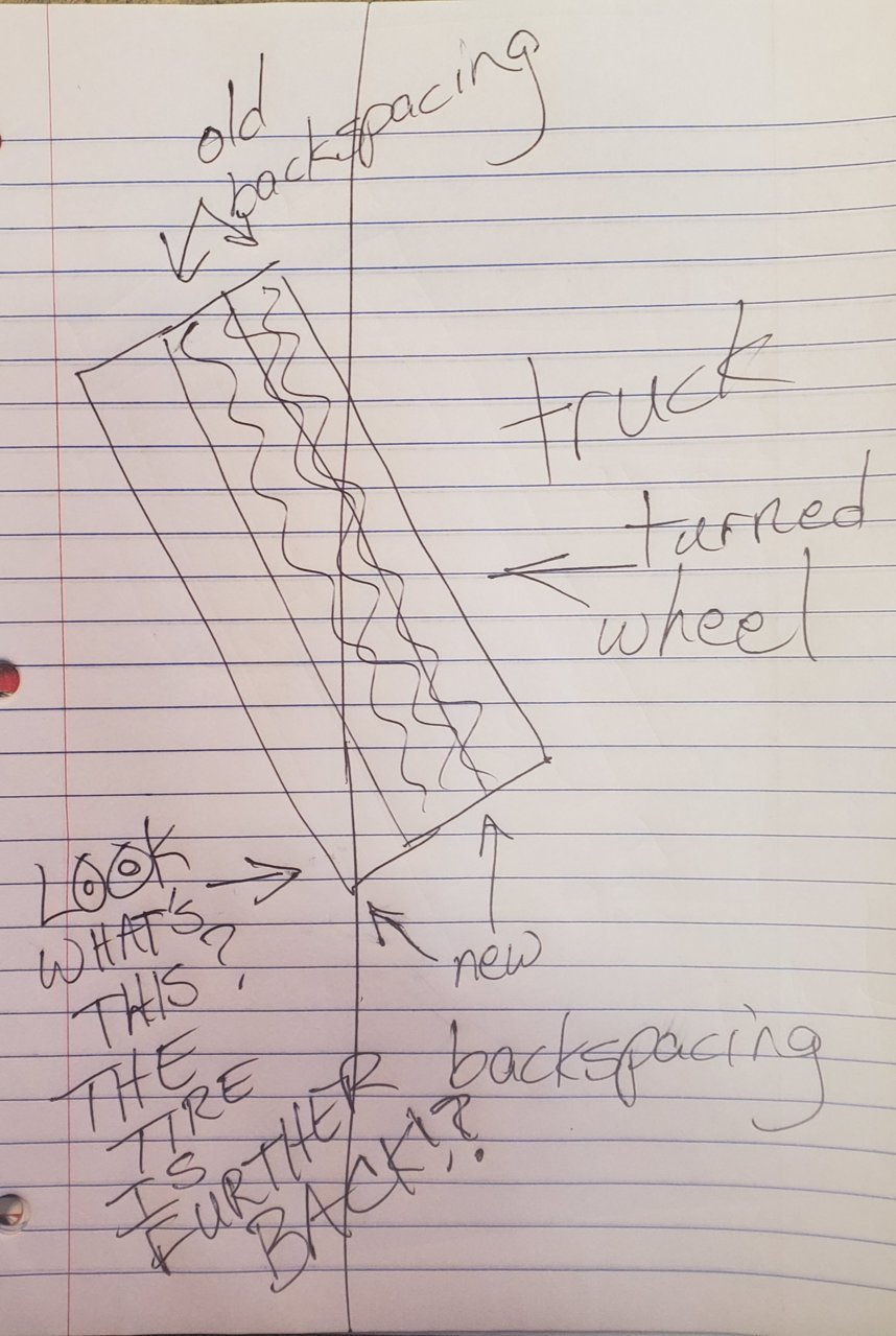

    Here’s a better example DG. In this picture if you add a wheel spacer I assure the tire will still be between these two lines meaning it has not moved forward or backward. The center of the hub is still in the center. But like a said before you have increased the track width, putting the outside edge further out than it was, while it will seem the tire is further back/forward 6E58F002-D5C3-4CA2-B806-0795C5520526.jpg and causing it to rub it’s because the turning radius has increased.
  17. Jan 1, 2020 at 7:10 PM
    #37
    DG92071
    DG92071 Well-Known Member
    Nov 29, 2019
    #312004
    2,996
    Yeah, exactly. Because the tire is further forward or back depending on the direction of the turn. You can write whatever the f___ you want lmao

    I was just trying to show you the the tire isn’t actually moving out of those lines. The tire(outer edge)is coming in as turn from a wider angle because the radius has changed.
