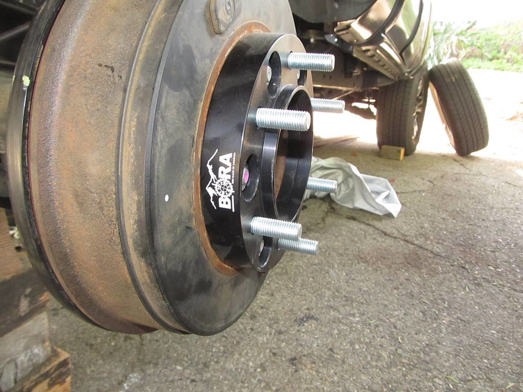

    what brand spacer do you have? and did you take a picture of the spacer mounted on the hub before you put the tire on? If you did can you post a pic on here?

    1" Bora wheel spacer on a 2018:

    thank you! I was interested to see how many of the stock lug threads poke out of the nuts provided with the kit....looks to be good.
