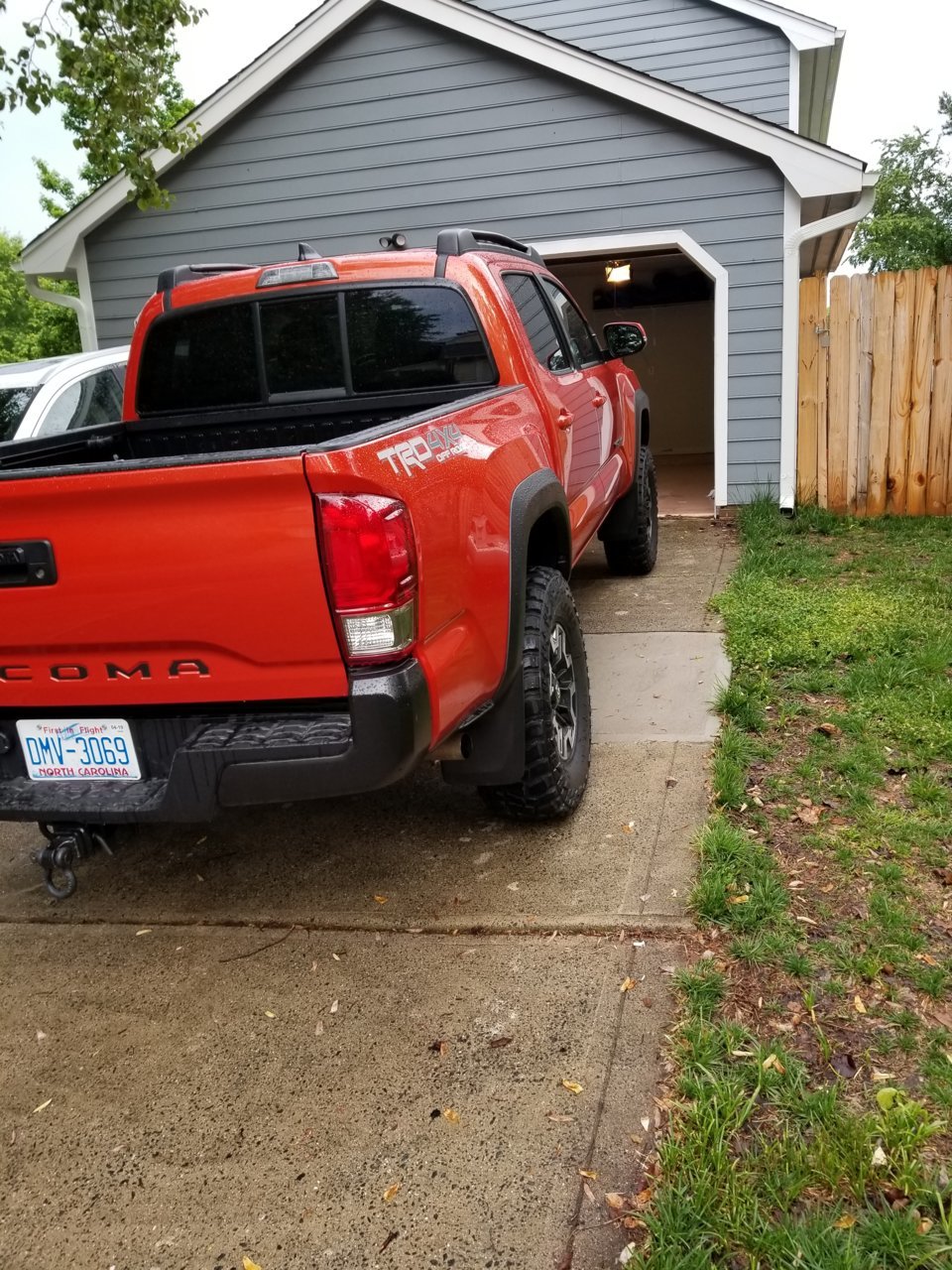

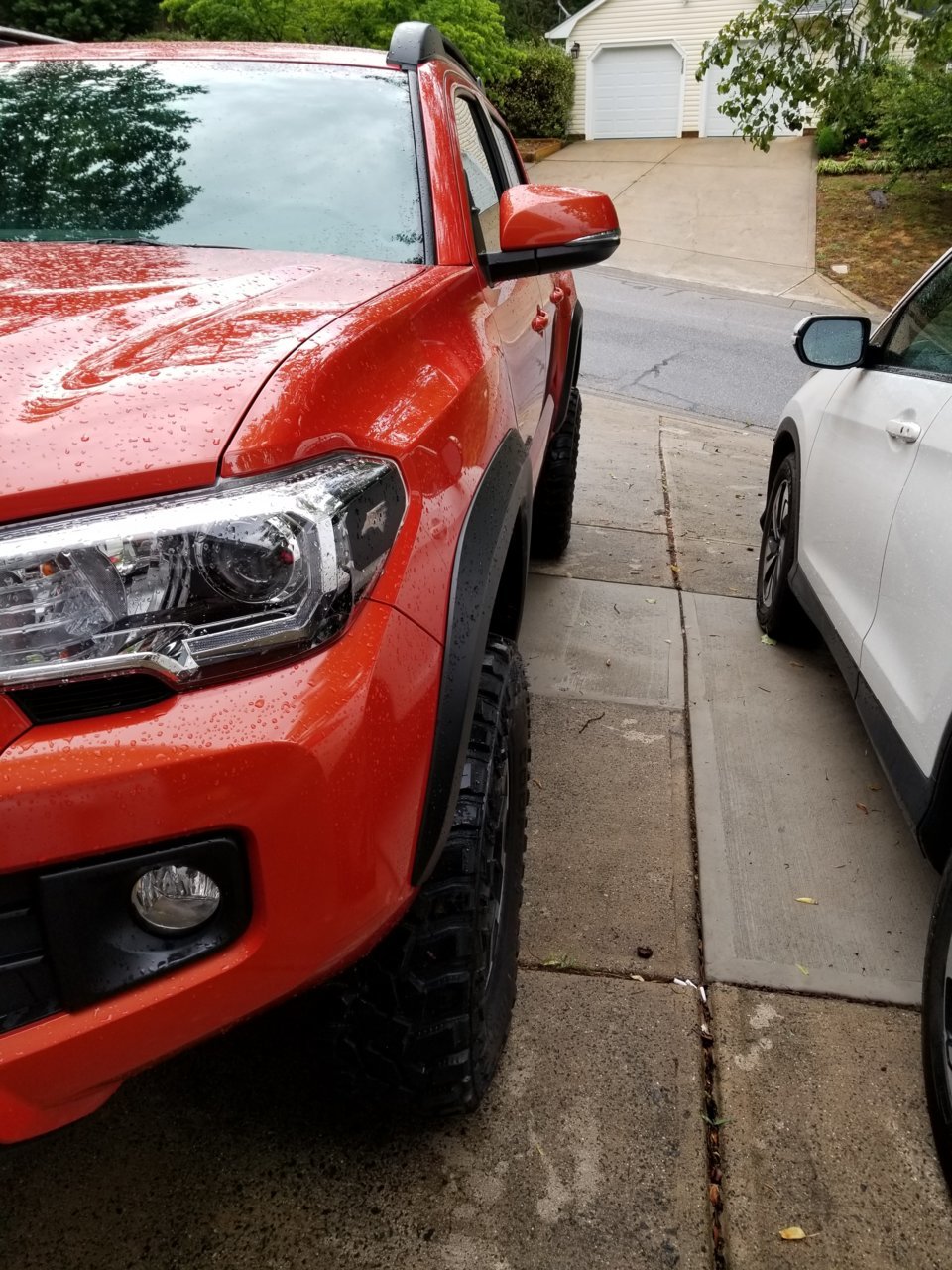

    I had stock wheels with 265/75/16, 1.5 inch wheel spacers. No rubbing. Really like the poke on the wheels with the 1.5 inch vs 1.25
    Now that I have methods with a 0 offset, whish I had 1.25” spacers, the 1.5 stick out slightly too far.
    I attached some pics that I have on my phone, sorry not exactly the best and don’t have them on my truck anymore.

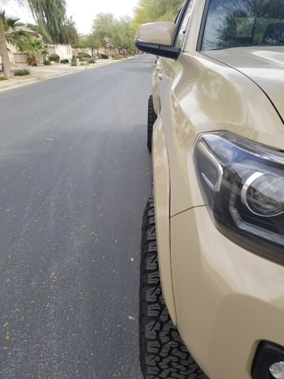

    I recently added 1.25". makes the stance much better. I'm planning on going 265/75 16 as well. not the best pics but hope it helps
    before:

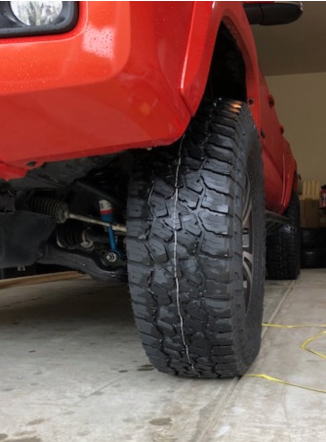

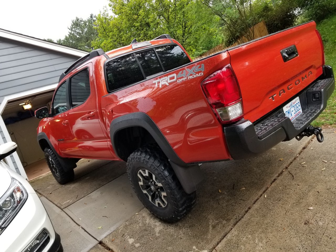

    265/75/16 Cooper STT Pro's on stock 2016 TRD OR rims. 1.25" spidertrax. 20180516_173702.jpg 20180516_191925.jpg 20180516_191725.jpg Before and after.

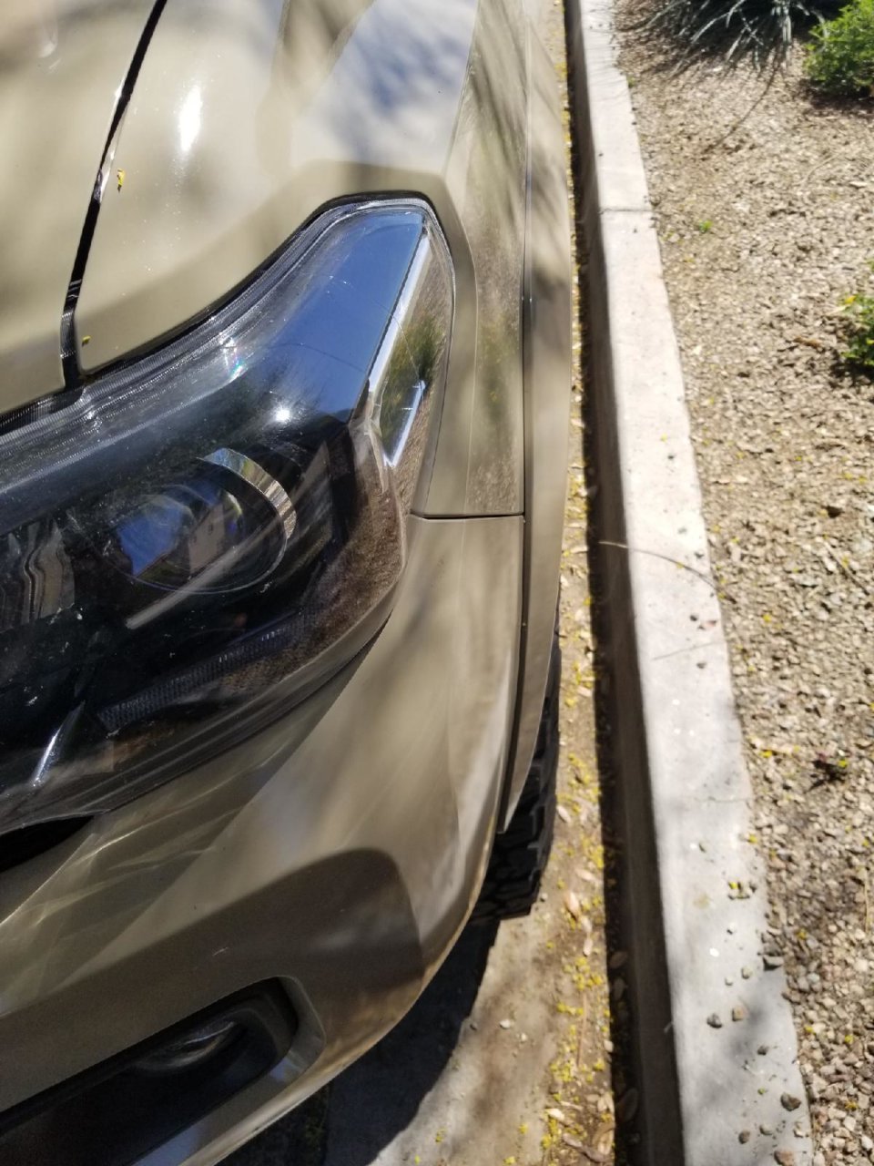

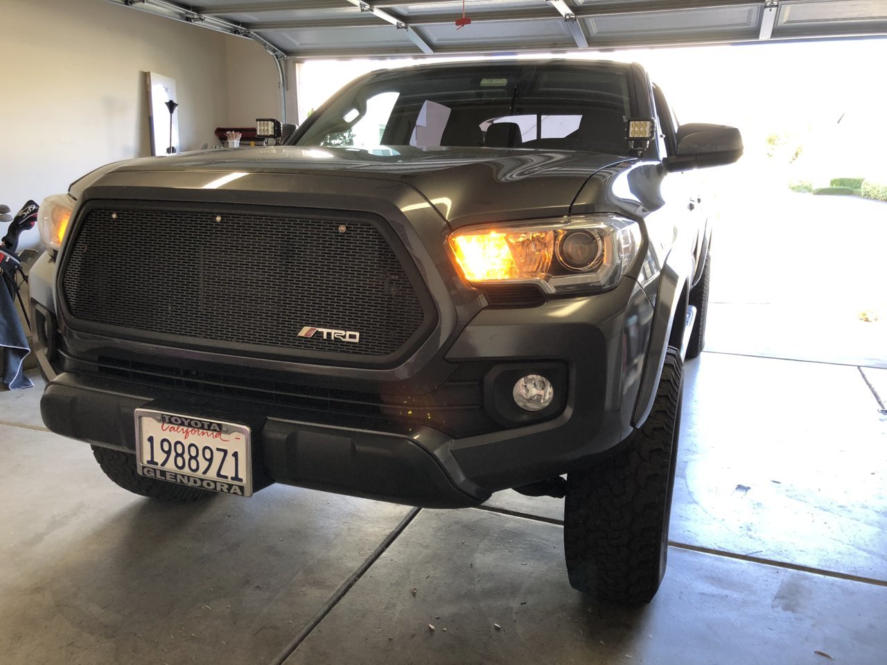

    Im running 1.25 spidertrax on 265/75/16 KO2s on 0 offset rim. No rubbing. Resized_20180405_105315_5510.jpg
    remgu2000 likes this.

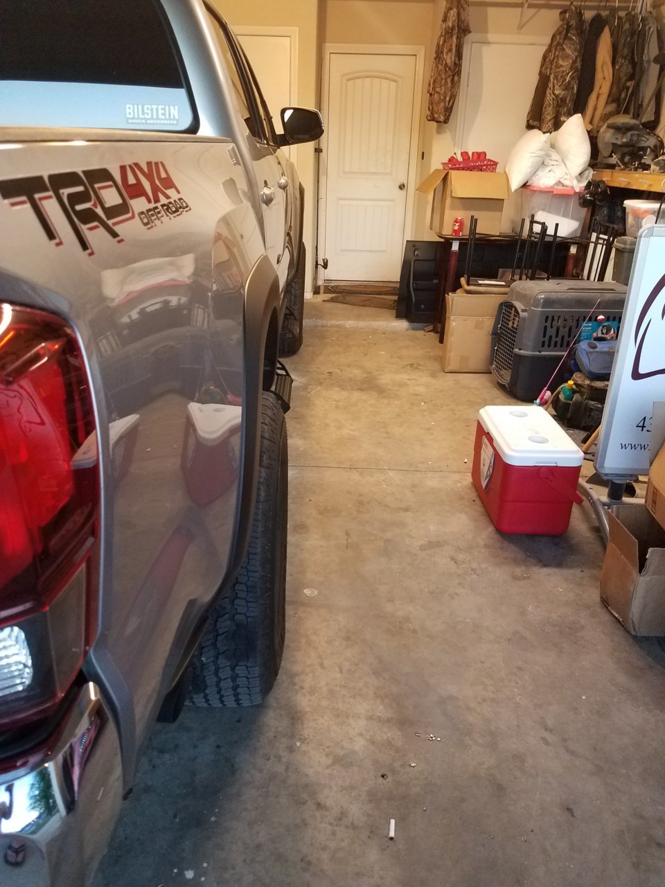

    I used stock sport rims (+35mm offset) with 285/70R17 Falken Wildpeaks, 2 inch spacers (total offset of -15) and it rubbed the very tip of the cab mount. I did a quick trim with an angle grinder and sprayed it down with paint - no rubbing and no issues. I will come back to it and do a more aggressive cut before I go on a serious wheeling trip though. For now it's good to mall crawl
