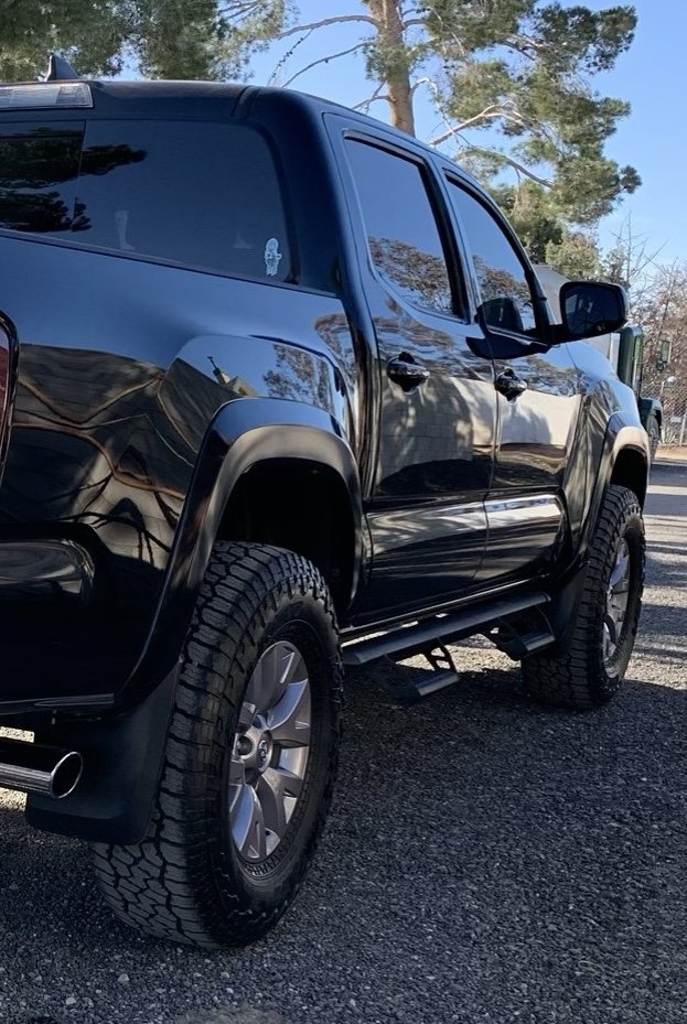

    Kings 2.5” front and rears from Accutune / ICON RXT LEAF PACK black badges doors and tailgate / method 315 / 255/85/16 Yokohama G003 / magnaflow exhaust , axle dump / meso int delete kit / meso led map lights / dome lights / wheelers front super bumps / accutune Flip kit with spacer and new bumps / Cali raised fog light pods / Cali raised ditch lights / RCI FULL SKIDS / SLIDERS / RCI rear bumper / rigid backup lights / tuned on 4.88’s
    4B4F6FAA-D137-4F10-8E34-798832564F54.jpg 1.25” spidertrax no issues. Definitely makes it look way better IMO

    That's a nice stance!
    71tattooguy[QUOTED] likes this.

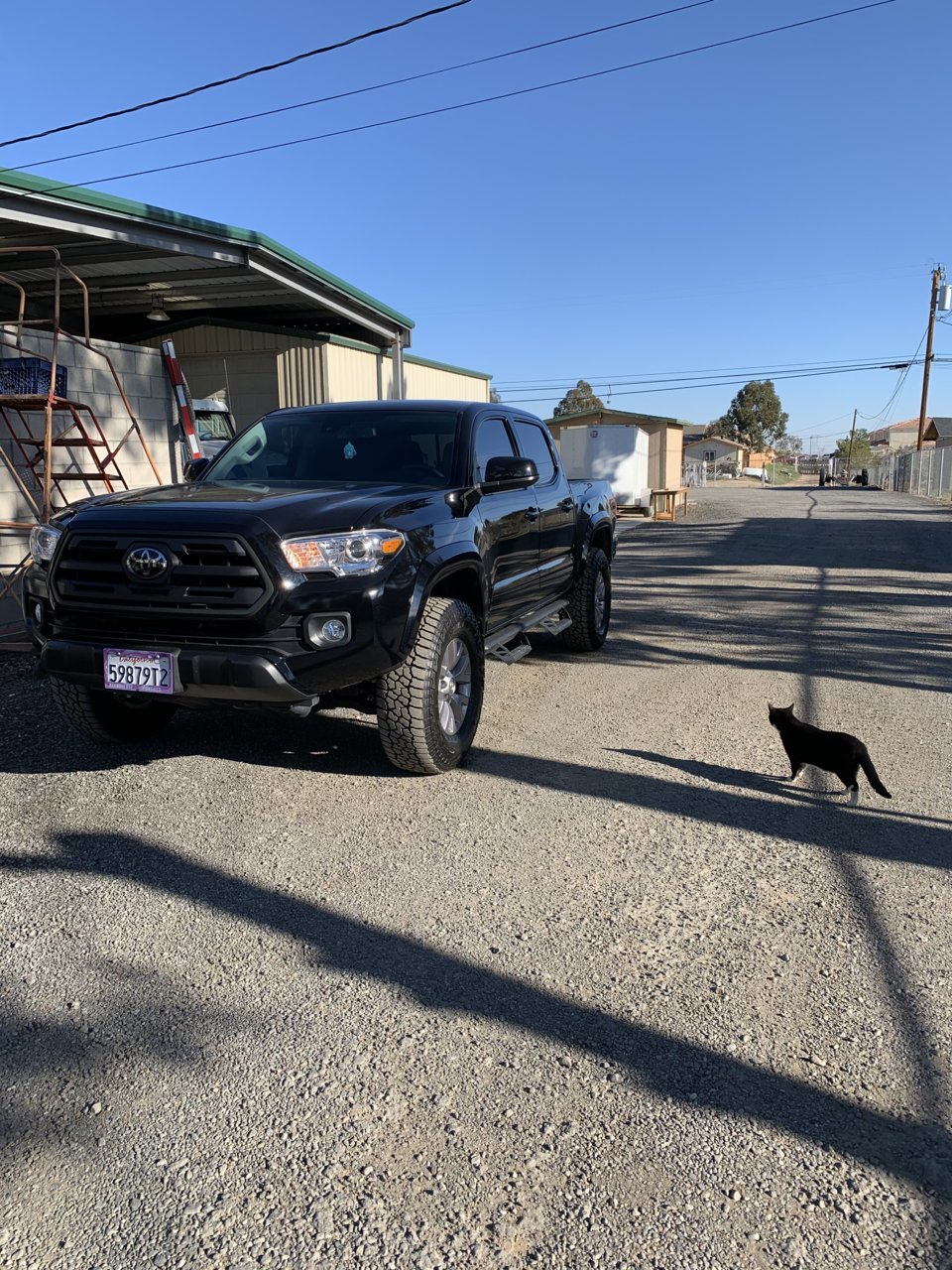

    I had 1.25inch on my stock wheels with 265/75/16 Falkens, before getting methods.
    It sat a little bit further out And did fling out rocks and mud like the other comment stated.

    That's a beauty. My truck came with the 3M film guard on the bottom 6 inches of the truck ( not sure if they all do? ) but should help. I like the way your truck looks. Same colour as mine, that has a nice aggressive stance.
