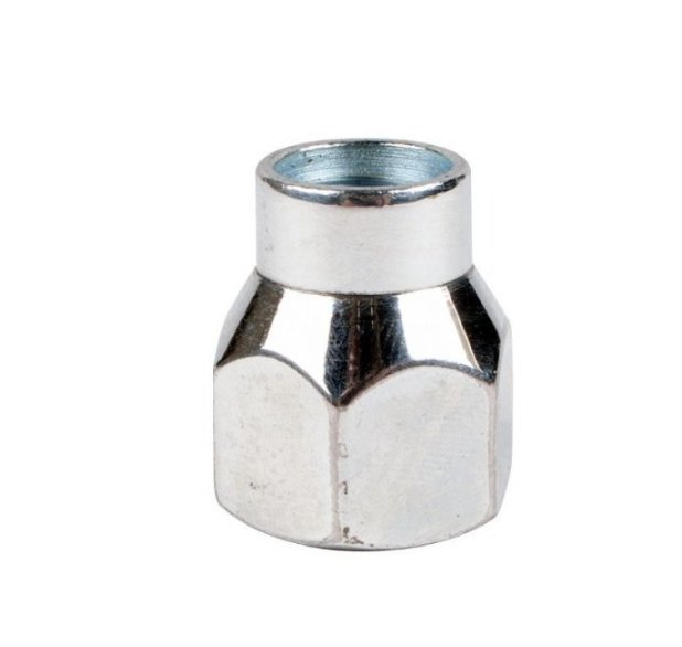

    Also if your front lugs are still shorter than the rear like previous gens:
    Use these for the spacers, at least up front:

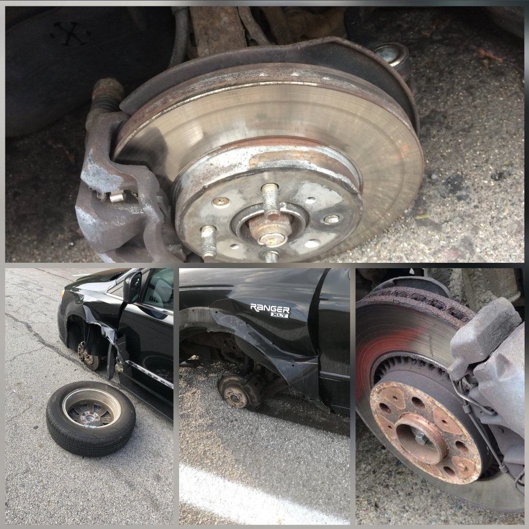

    Wow we're on page 3 and no one's posted picture of the wheel that fell off with the spacer still attached? The anti-spacer crew is slacking.

    I got one better. Wheels came off without spacers... How can that be?

    Over torqued? Twisted studs finally snapped?

    What you don’t see in the pic is the spacer broke so violently it flew out of frame, landed on a school, and took out all of the children.
