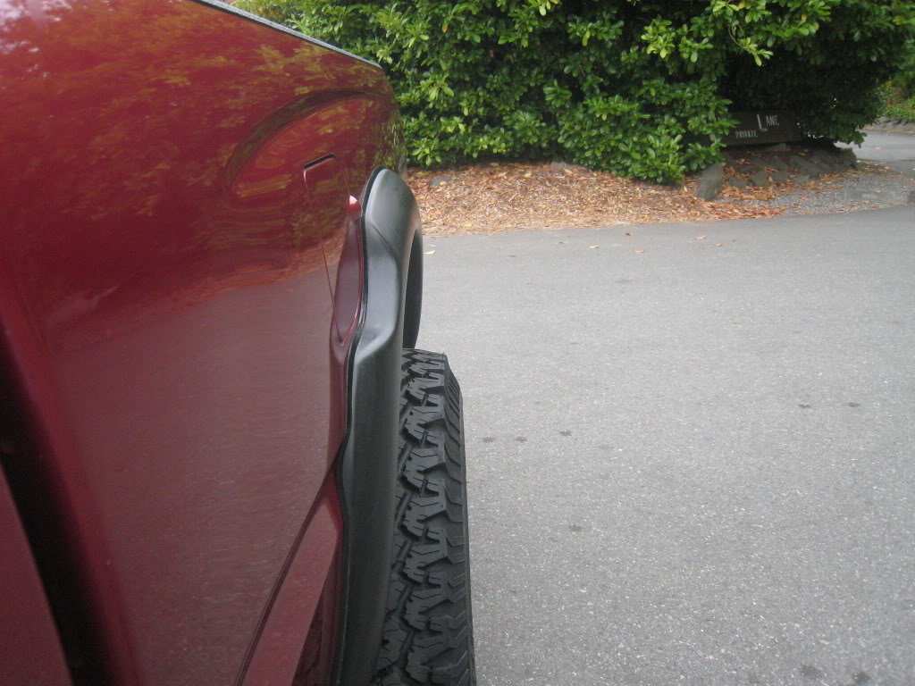

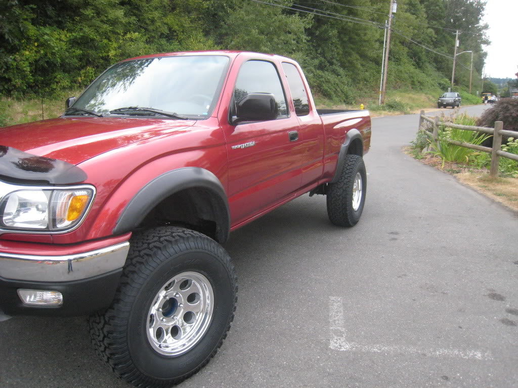

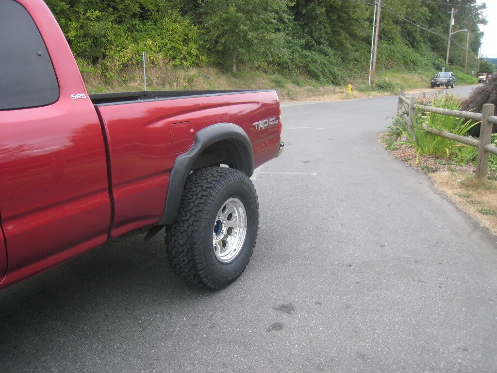

    I run 1.5" Spidertrax wheel spacers on mine. I absolutely love them. Check out my thread if you want to see more pics.
