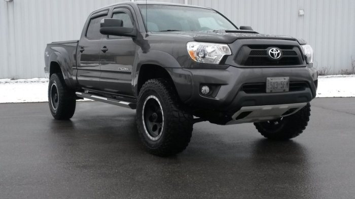

    Why?
    Buy wheels with the right offset and back space = no spacers.
    Mine:
    3" Lift
    Wheels: MT 17x9, OS: -12, BS: 4.5", CB: 108mm
    Tires: MT ATZ P3, 285/70/R17, 33"x11.5", E Load
    ... had to lose the gaudy front flaps, very minor trimming...
    c3391500-95ff-47cd-b6e1-e42f3a296a34_zps_0c4f3755fe0db46fa0c9f21432e9e0bfbe9f26f0.jpg
    Just sayin'

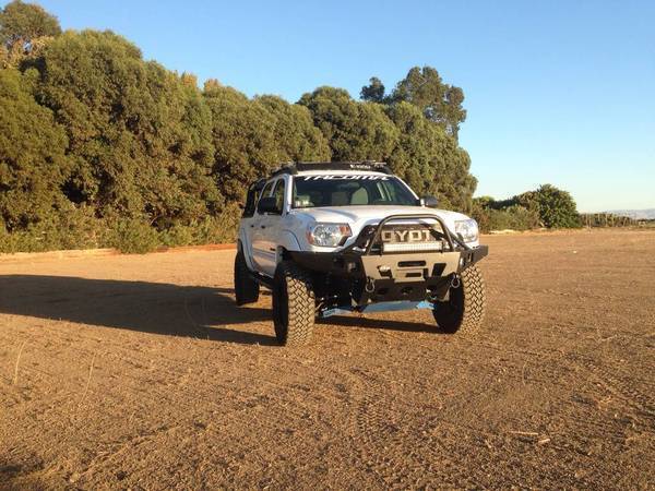

    enough to go over stuff
    If you dont go cheap then wheel spacers wont kill you. They will just look cool.
    I have 4 spydertrax on mine with no issues.
