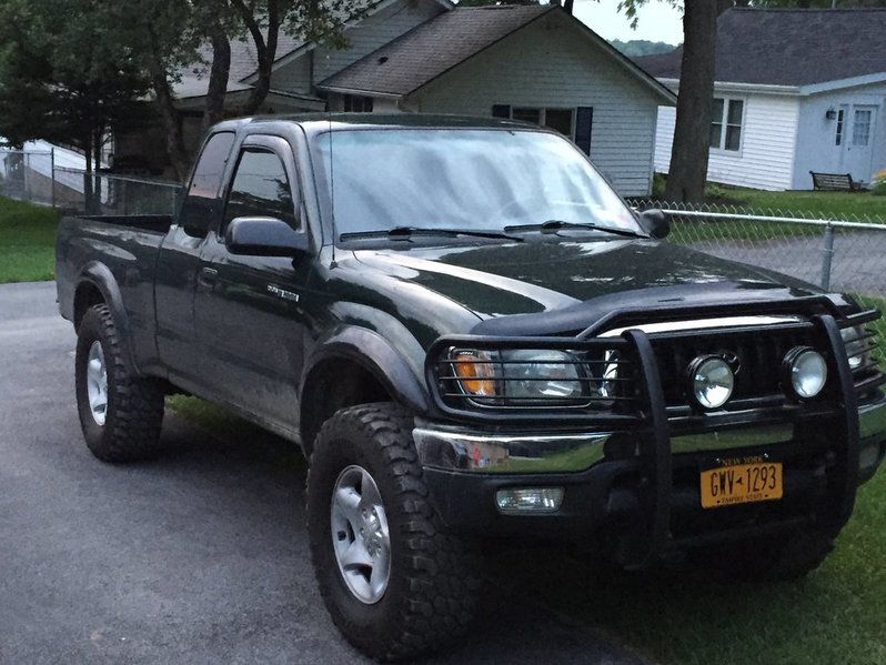

    Running 285 tires on my '04... They rub a little on full lock. The truck has a small lift of 2" I think.
    Wondering if 1.25" spacers would help with this? Anyone here run into this?

    Yes you'll be in good shape. I'm on 285/75 w/ 3" lift and 1.5" synergy spacers, no issues. 1.25" should be enough, only ran 1.5 cause of my wheels.
    Here's how far my tires stick out, won't be too big a difference for 1.25

    Thanks! I was on the fence between 1.25 and the 1.5! Think I may go with the 1.5 after seeing your truck! Any chance you have a pic from the side?

    Yeah man here you go
    These were the old tires
