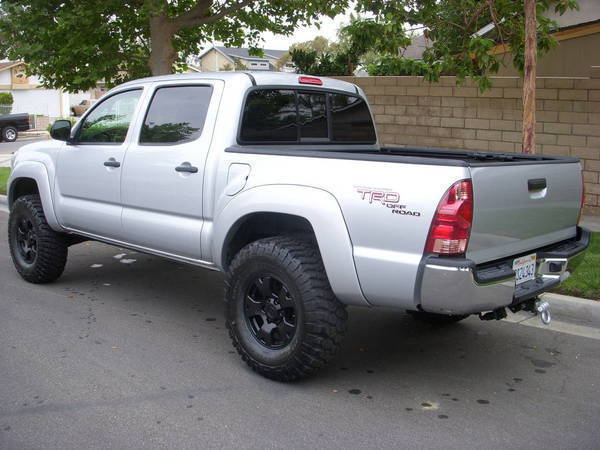

    I dont think it really helps with the larger circumference. Your lift is what helps you with that. If you go with a wider tire on stock rims, the spacers help you. Other way is to buy wheels with a different backspacing.
    As far as alignment goes, I havent took mine to get aligned yet. But I know others have these and have had no issues that I heard of. I run them on the back too. It looks really good

    idk if you can tell but it does widen the stance a little. they are 1.25" spacers. So your truck will be 2.5" wider
