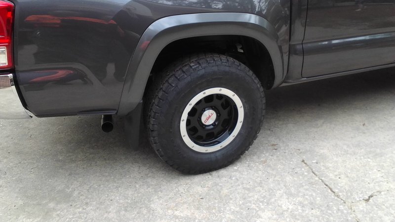

    Post a pic of your wheels....

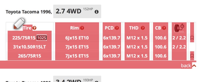

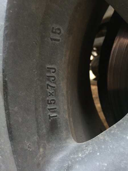

    I believe this says positive 10mm? Am I wrong?

    Are yours the 15x6?

    7" sorry.

    If you did a 9" wide wheel with -12mm offset, that'd get you sticking out 2" farther than stock
