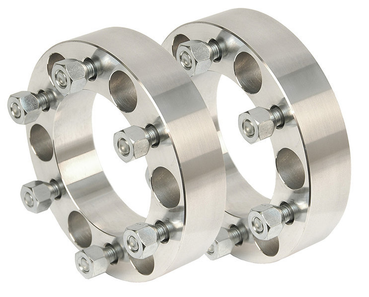

    Hey guys, I got some chevy wheel spacers I wanted to use on my tacoma. I know the hub bores are different sizes so for my question,
    If I take some material out of the center on the lathe to make the bore 108mm, do think in with affect the spacer? Or should it be okay? I can't imagine it doing any harm, Has any one ever done this?
    Thanks in advance.

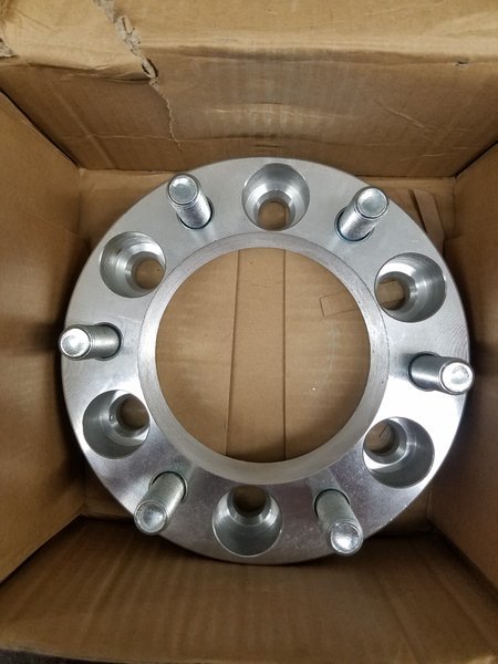

    Well there it is..

    Looks the same to me. (These are toyota spacers)

    Yeah I agree, I shouldn't of made this thread. Just was wondering if some one has done this before..
    It took no time at all and I just physically compared them to an actual toyota spacer my buddy has and there Idebtical.

    They were meant for a chevy, I just put them on a lathe and made the center bore 108mm
