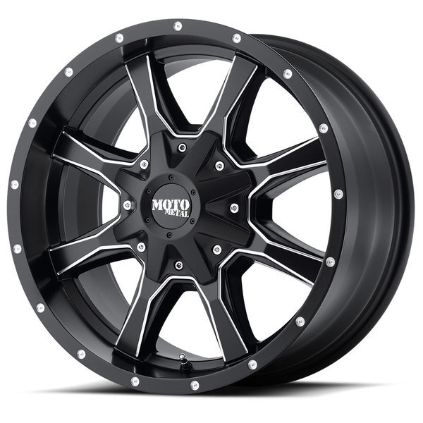

    IMG_8505.jpg I am having these wheels put on my truck tomorrow. Will they stick out from the truck at all or do I need spacers??

    What are the specs?
    Size?
    Backspace?
    Offset?

    Im not sure on all the specs. I picked out the wheels and tires and the guys at the shop did the rest of the work. I know they are 17" and im putting 275/70/17 tires on it.

    I was just curious since the center of the wheels is centered and not pushed out to the edge. I was wondering if that would push them out.

    They are nice wheels, Moto Metals usually poke out of the wheel well pretty nicely.

    I think these are the specs
    • Wheel Size: 17x8
    • Bolt Pattern: 6 on 135 and 6 on 5.5
    • Backspace: 4.5
    • Offset: 0
    and it looks like you probably have TRDOR wheels on it now which are
    16x7, +32 mm offset, 5.25" backspacing, 6x5.5" bolt pattern
    so yes they'll poke out

    This. Are they hub centric or lug centric? I'm assuming lug centric. Did you get adapters and does the tire shop you go to do road force balancing? Lug centric wheels require different balancing techniques most shops don't do.
    Can be done, but details you want to know upfront.

    The center bore is 106.25 so it I believe they are hub centric
