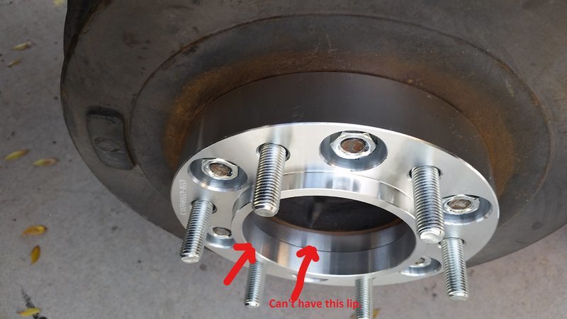

    Will they work if I have manual lockout hubs?

    You need to get lug centric ones like these: or these:
    http://www.ebay.com/itm/4-TOYOTA-WH...USA-/162129715624?vxp=mtr&hash=item25bfaf21a8
    I just bought 2 of each and they look identical so it's up to you how much you want to pay. I did also buy some extended thread lug nuts from all pro in my order for the front wheels.
    Disclaimer: I haven't put them on my manual hubs yet. I can't say for certain that they will fit, but I'm pretty sure they will, that's why I bought them vs. hub centric ones.

    vs. hub-centric that would have a hub adapter for the wheel to sit on that would interfere with the manual hub's OD. There are ways to mod such spacer / adapters, but you'll need a good router and a good amount of patience in marking out the locations to route out and some trial and error.

    They won't fit over the manual hubs w/o significant modification.

    For anyone thinking that hub centric wheel spacers hold a wheel to the hub any better than a lug centric one:
    • "The hub center of a hubcentric spacer does not hold the spacer on the hub or reduce the chance of stud failure. There is never any load on the lip of the wheel spacer. For there to be a load on the lip, the friction force in the joint must have been completely overcome. The lip on a hubcentric wheel spacer serves only as an aid for wheel installation."
    http://www.maximummotorsports.com/tech_wheels_spacers.aspx
    Follow the star pattern in tightening tapered conical lug nuts and the wheels should sit centered on the hubs w/o vibrations.

    From the great depths of the interwebz:
    It's the outer-most nuts that get in the way:

    thats good info. il bookmark it the next time someone asks. looking at it 1.5" spacers would probably clear without modification.
