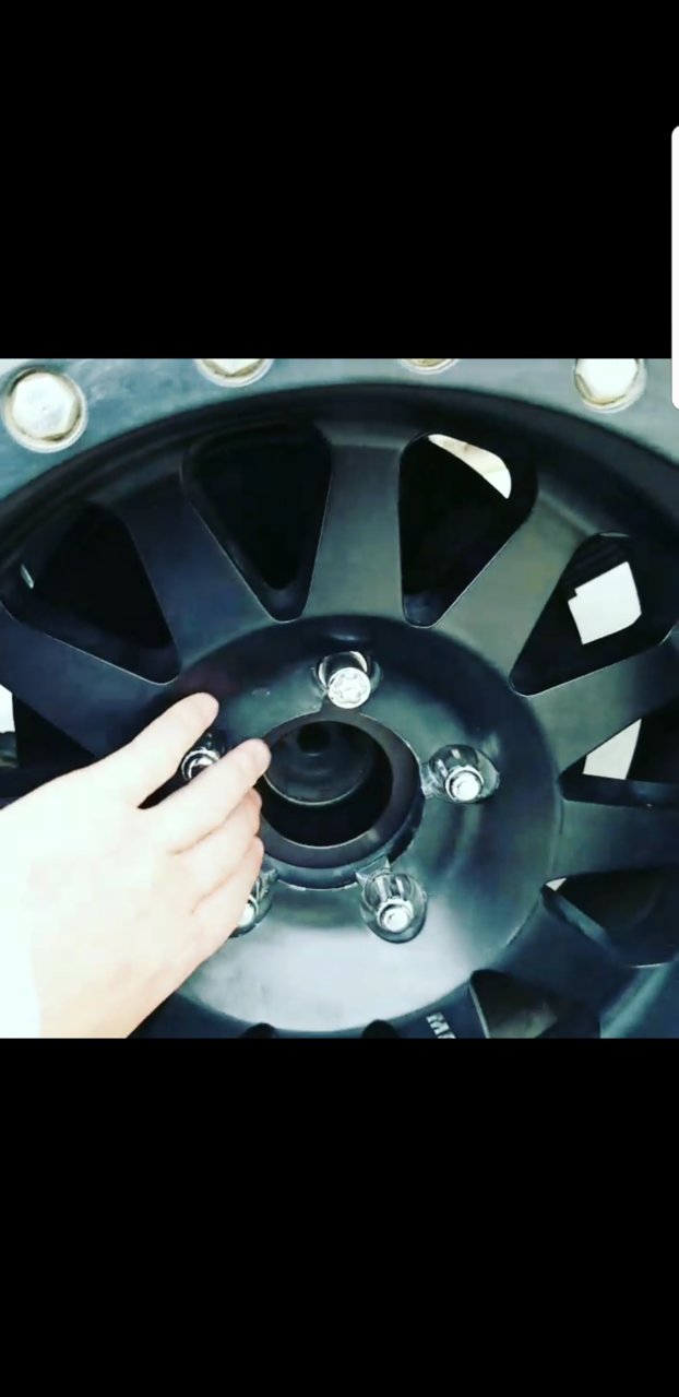

    how many people use lock tight or just tight to OEM spec?
    running 1.5 in the rear.
    bora says no lock tight and just tight to spec drive 5 miles and re-torque recheck every 3,000 miles
    mine are hub centric to oem hub and hub centric to my method rim
    don't mean to ask this question again just really dont like spacers......

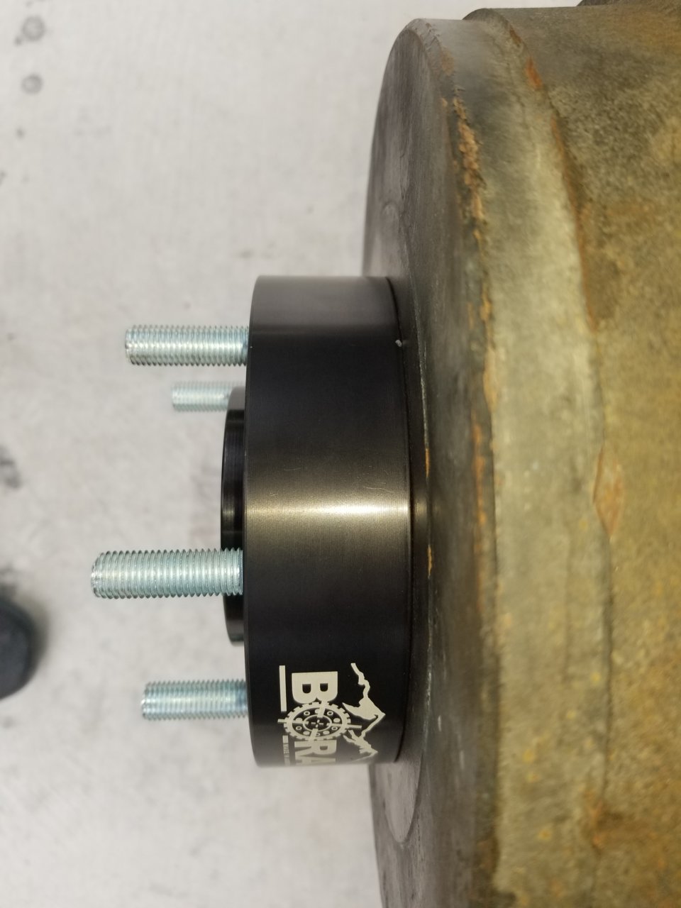

    Had BORA spacers for 3 years. No Loctite, however, even if you use it I highly recommend checking the torque periodically. At least during first 500 miles. Once they "settle" so to speak then check at rotations - should never move.
