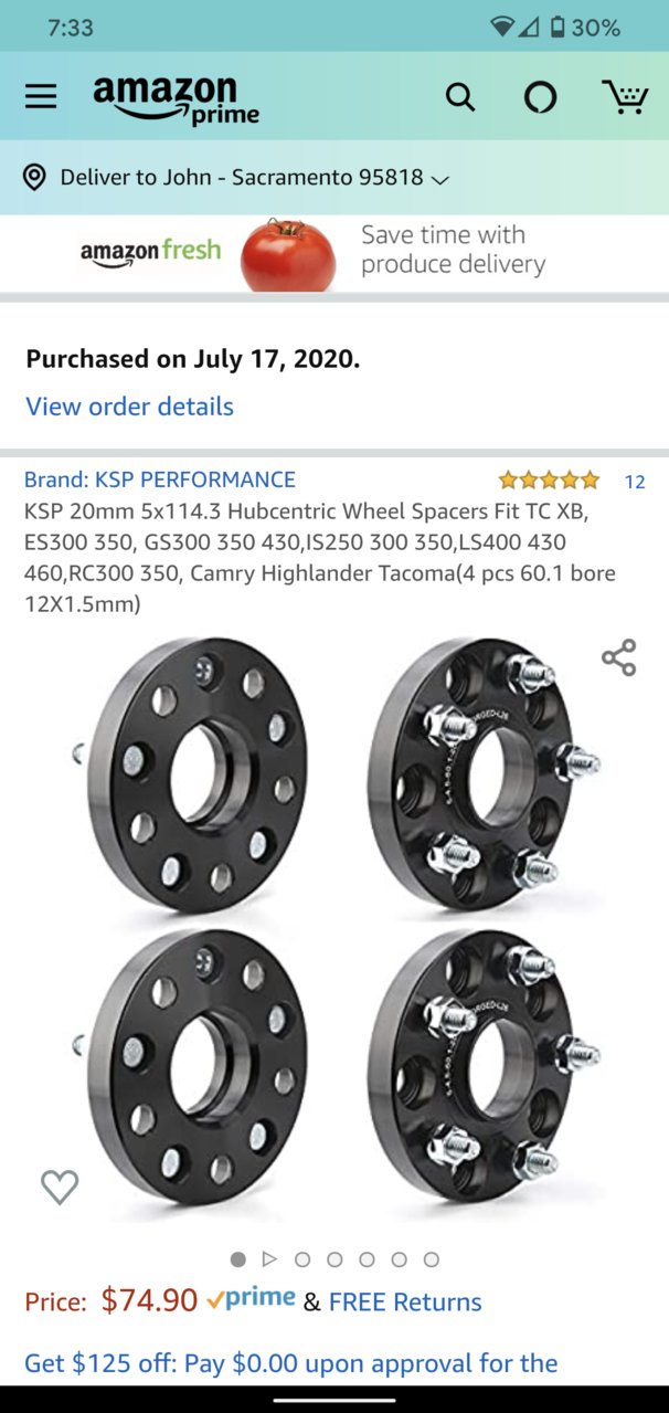

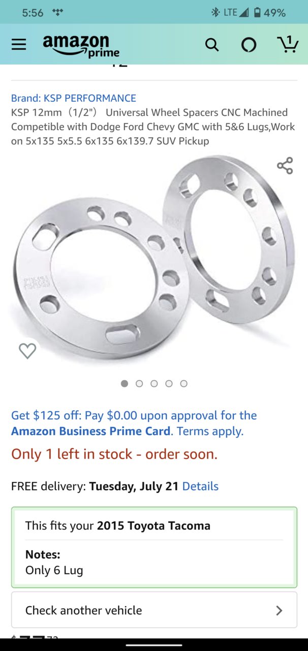

    Magnuson Supercharger, Speedhut AFR and Boost Gauges, TRD ECU Reflash, Factory Nav Unit, TRD Skidplate, VIP alarm, 265/75R16 Cooper Discoverer ATP, 1" KSP Spacers, hub centric (hold comments lol), TRD Pro Grill, Raptor Lights on with ignition. Upcoming - purchased, not yet installed: Body matched rear bumper (rattle can), Kicker Hideaway, JL Audio 6x9 components w/80Hz Bass Blockers, Hellwig anti-roll bar, TRD Short Shifter, Knock-off TRD Shifter (non-Qball), black throwback plates. Plans: more.
    Screenshot_20200717-180551.jpg I bought these from Amazon, said they'd fit my 2015 4.0l, but America's Tire won't install them for "safety reasons". Is this just liability or should I go with some bolt ons?
    Updated to correct spacer image.

    The thing with spacers like these is they are more dangerous, in that less of your lug nut will be threaded onto the stud when you use them. By however thick the spacer is. The thicker ones like the 1.25" come with their own, separate studs pressed in - and the lugs thread on to them fully.

    Man thanks for the quick reply. Mine are only 1/4", I figured there would be enough threads to grab. Any opinion?

    its not just the available thread but the fact that the wheel center is not supported on the face of the hub. The lip on the hub face should fit into the wheel center. Cheap spacers like the ones pictured above will move the wheel out away from that lip and it will be "hanging" on the studs.
    The studs/nuts should only be responsible for holding the wheel onto that lip. You don't want the weight of the vehicle resting on the studs only
    Spidertrax/Bora style is a perfect match of the OEM hub face, technically they are true "axle extensions".
    The thinnest Bora is 3/4 inch i believe. Anything thinner than that and there isnt enough room for the lugnuts to fit (the ones that bolt the spacer onto hub). Some wheels have a little pocket of space between the stud holes, my OEM 4runner wheels do. Some people have had to shave down the studs when their wheels are completely flat on the backside. A lot of aftermarket wheels don't have those little pockets I've heard..
    I had the 3/4 Boras mounted with the 4runner wheels in the past. Never had a single problem for over 2-3 yrs and 75,000 miles before i took them off. I literally forgot they were on there

    I never thought of that, makes perfect sense. I ordered some of these. Thank you for the info, apologies for temporarily hijacking the thread.

    Now that I'm looking at them they are only 5 lug. Just ignore me, I'll figure it out.

    Just spend the money on the boras..... 50 bucks a spacer peace of mind. Blue locktite, not red, and check them every oil change/ tire rotation.

    These are not hub centric. Not really safe to use.
