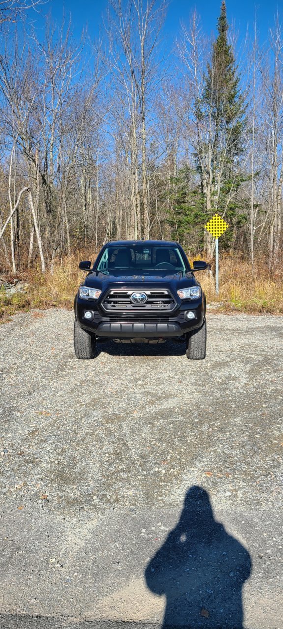

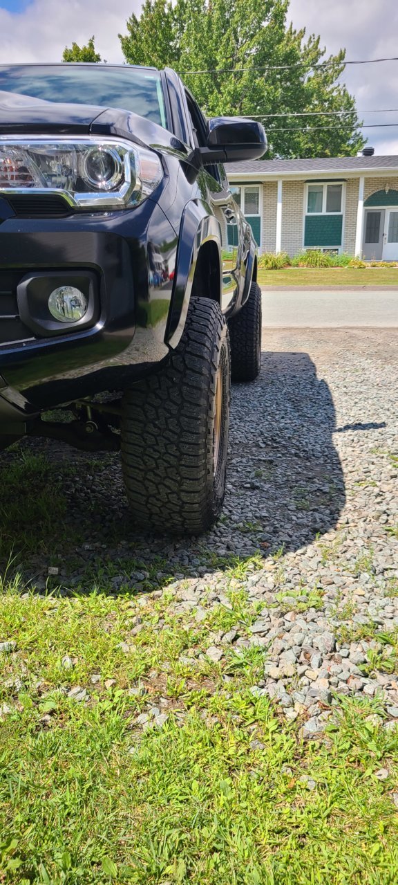

    Nikolav1990
    Nikolav1990 Well-Known Member
    May 26, 2016
    #187990
    180
    Niko
    Magog, QC, Canada
    2018 toyota tacoma sr5 access cab automatic 2.7
    I have had 1.5 spacers for over 1 year now from Amazon i paid 130 shipped to my house, they seem well built and solid, no problems with them and many of my buddys have had them on their trucks for years also and no problems, never heard of anyone having pronlema with those around here they are pretty popular and i like the look it gives with the stock rims and aftermarket rims too20210822_125249.jpg 20211107_102023.jpg

    Nikolav1990
    May 26, 2016
    #187990
    180
    Niko
    Magog, QC, Canada
    The cheap ones i got were hubcentric and fit tight to the hub, also put some locktite on the studs, nothing has moved and re toqued when i put my winters on
