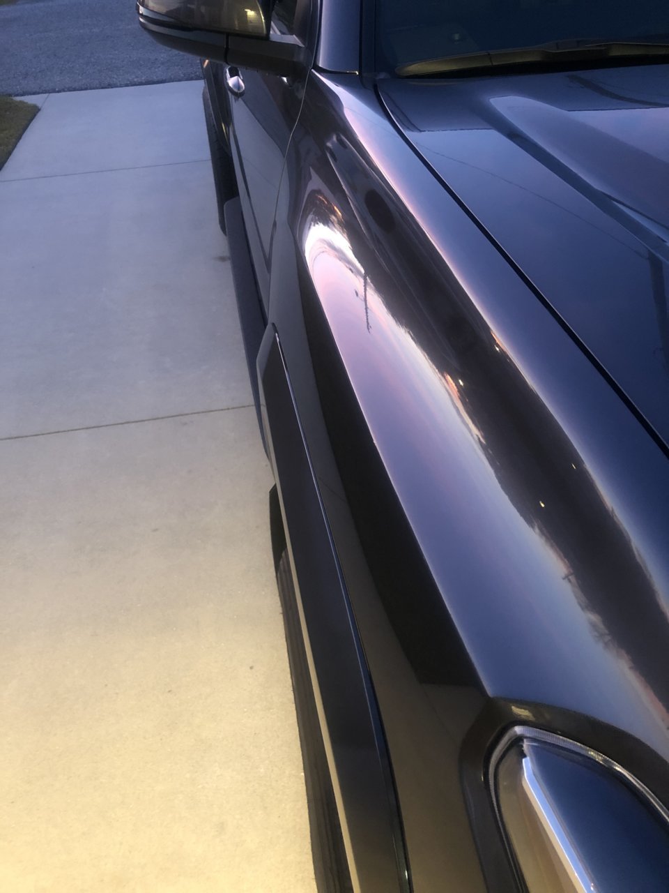

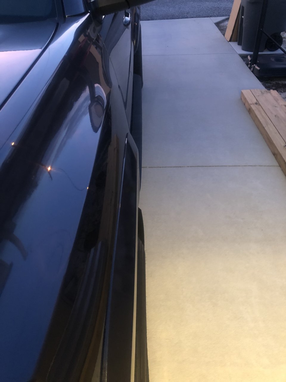

    this was the sport wheels
    3FED0445-B225-43DC-A8DF-F98E12034A55.jpg F8CFD687-F80F-435A-B27F-BE52906ADB00.jpg

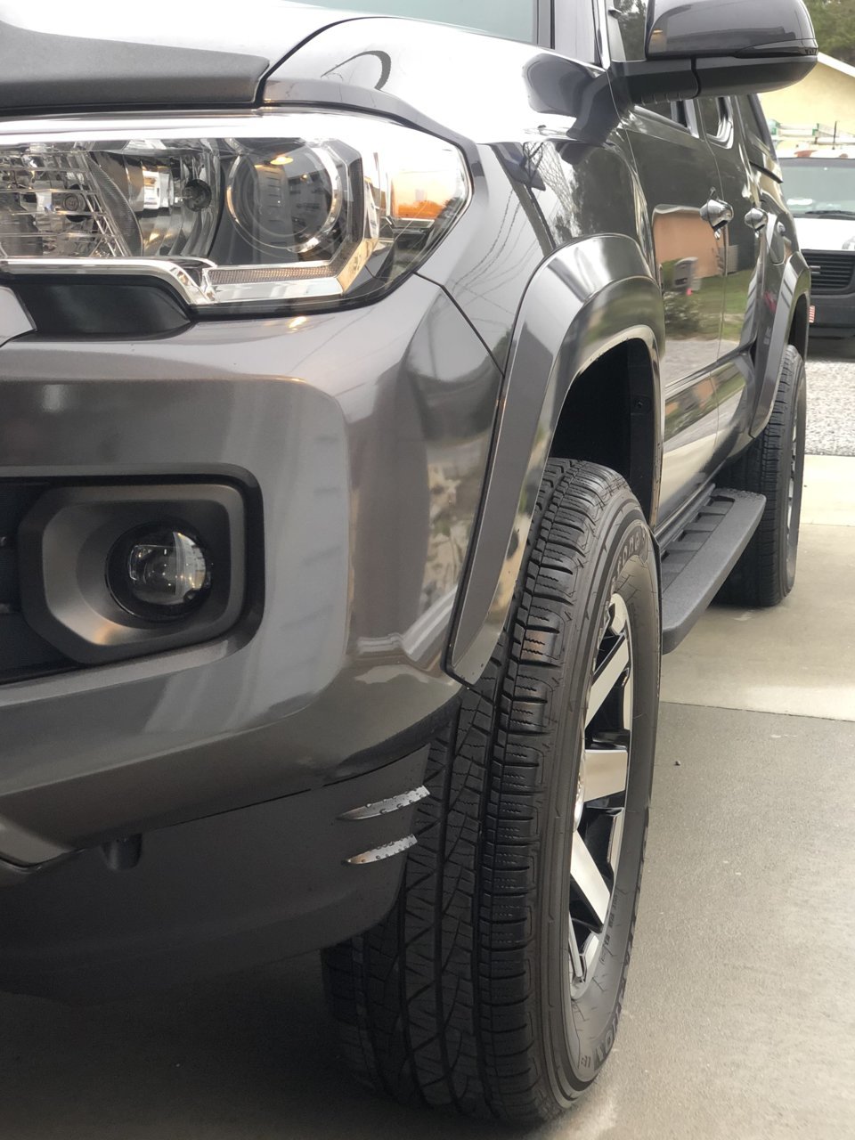

    This is the best I have for the t4r trails. Second pic is deceptive because of the angle
    basically the corner of the tread is even or less then 1/4” past the fender

    Nice truck and nice setup! I actually really like the spacing. I will got with the 1.25. Much appreciated
