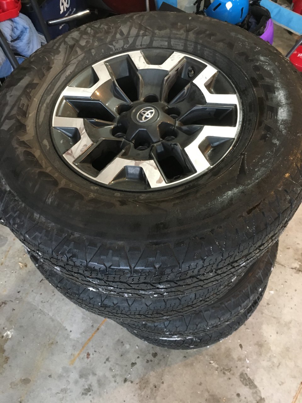

    I would like to put 1.5” wheel spacers on my truck with stock 2018 Tacoma 16” rims.
    I know the offset is different on the newer wheels and I like a little wider stance.
    Will 1.5 be enough?
    Any recommendations on brands?
    Thanks in advance !!

    I would definitely not go any more than that. Just to correct for the backspacing, you should only need like 1/2" or so.
    As long as they are hub-centric style, you should be fine. IMO brand doesn't really matter when you're talking about spacers. They're just chunks of metal with some bolts. Spacers really are just a bandaid fix anyway; to cover up for the fact that you're running wheels with too little backspacing.

    I'd try .75 Bora first and see how you like it, little more subtle

    So I’ll tell you confidently 1.5 spacers will make those wheels rub badly on the frame and pinch weld. I have the exact wheels from a 2016 TRD OR. 1.25 rubs too.

    I concur!
