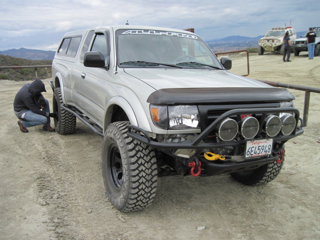

    But I'll throw up some other 8" wheel width mountings.
    Here are IS wheels (Ivan Stewart) 16 X 8 @ 4.5" BS (oem)
    These had 265/75/16 tires mounted to them.
    ^ Nominally measured... these are about 31.8/10.50/16
    * a 10.50" tire width is about max utilizing the oem 4.5" BS'ing

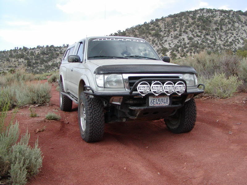

    and here is a pic of 16 X 8 ProComp steelies @ 4" BS (Wheeler's type "B")
    These had 285/75/16 tires mounted.
    ^ Nominally measured... these are about 33.1/11.50/16

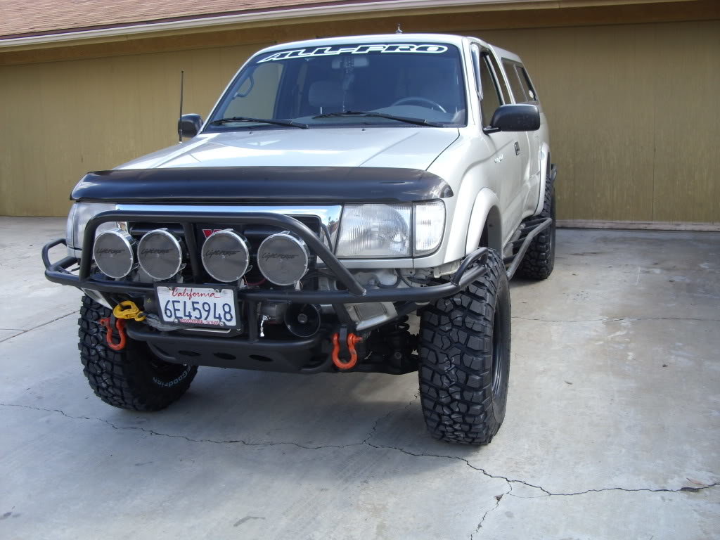

    Next step up...
    ProComp 8069-6883 alloys 16 X 8 + 4" BS + -11mm off set
    These wheels are sporting 295/75/16 tires...
    ^ Nominally measured... these are about 33.6/11.65/16
    ~not only taller... these are about .25" wider then a 285~
