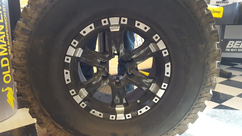

    I'm stupid when it comes to wheels, anybody know anything about these? Theyre 17's and the owner said they are stock chevy backspacing. I'm debating buying them but i dont want a wheel that I'm going to have to run large spacers. No spacers would be ideal.
    The tires on them are 35's.

    "Stock Chevy backspacing" is way too vague. Looks like the wheels are off the truck, he should be able to look at the specs on the inside of the wheel and easily tell you specifically how wide they are, and what the offset is.

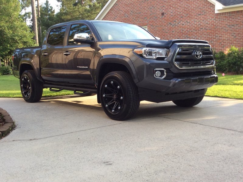

    Would this wheel spec work on a 2016 Limited 2wd:
    139.7mm Single Bolt Pattern/Offset: -12mm / Backspacing: 4.53"

    Need more info. Wheel width. Must have a 106.1 center bore. 7" wheel at -12 = 3.5 back spacing thus tire will stick out 2" farther. 8" = 4" back spacing. 9" = 4.5" back spacing. Stock Toyota wheels are +30 offset. Most of the stock Tacoma wheels have 5.4" back spacing.

    The tires stick out about 0.5" pass the mud guards. I like the look, but I need a more aggressive tread than the LTX MS/2's.
