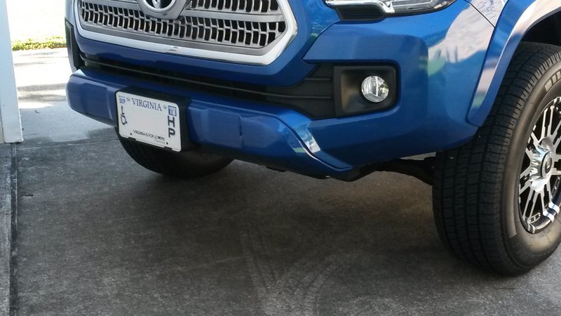

    Wanna see those pictures when you're done. I think I will go more to a zero offset with the 18 or 20 inch wheels just to give my wheels some dish. The 17 x 8's I used are ok and were very budget friendly but would like a wider lip and probably chrome or polished. Now trying to decide on tires. All street here so can't justify KO2's even though they are great tires.

    What offset are these wheels in this picture? Stock suspension it looks like as well? Nice stance.

    -12 & yes the suspension is stock. Thanks for the compliment!

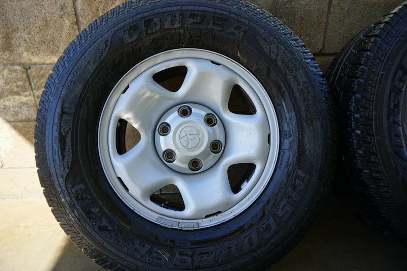

    Looking for some help identifying some 2nd Gen wheels. I need another 16" spare for my 1st Gen that I am running 16" 2nd Gen trd offroad wheels (5.25" backspacing).
    Would someone mind telling me what the back backspacing is for these wheels? If i am not mistaken these are the sr5 2nd gen 16" steelies?00606_ebHpHKgZOKo_1200x900.jpg
    So where I am needing knowledge is, If it is a issue to run a full size matching spare wheel/tire that has different backspacing then the other three? I am thinking longterm and not just limping off the trail. Or is the backspacing not a big deal? Also what is the disadvantages if any of running a steel wheel paired with 3 other alloy wheels? I know the weight would be different but just wondering if that can cause negative side effects over time?
    I essentially wanted another matching trd offroad alloy to match but I am having trouble finding just one for sale. With just guessing I am thinking that the spare being steel and different backspacing is not really a issue to be ran longterm because thats what my current oem spare has. But I would like to have two spares for long/out in the middle of "nowhere" camping/trail trips.
    Thanks for helping and the education :)

    FirstGen Jer, I just bought those same wheels and put them on my 1st Gen. They are stock 5.25" BS....which made mine sit in from the 4.5"BS alloys I just took off. They fit fine, a little close to the UCA, but I'll grab a .75" or 1" spacer to push 'em back out. My steelies came off a 2014 Taco and I put them on my 03. Hope this helps but by reading your question, they should sit exactly the same as your other 2nd gen wheels. Good luck!
